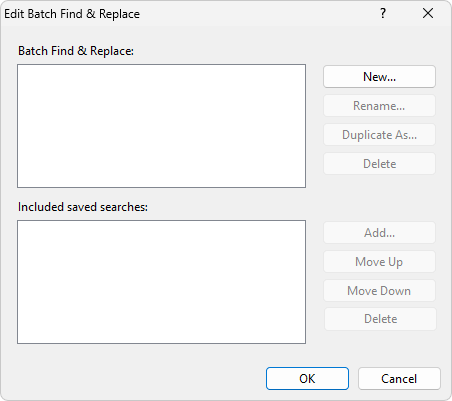

The "Edit Batch Find & Replace" dialog would pop up:
The 'Edit Batch Find & Replace' dialog
Click the "New..." button to create a new "batch find & replace" set:

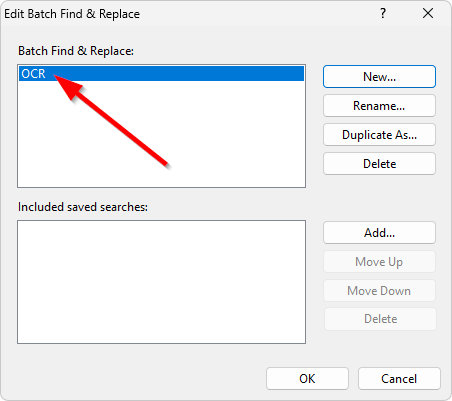

New 'batch find & replace' set
New 'batch find & replace' set created

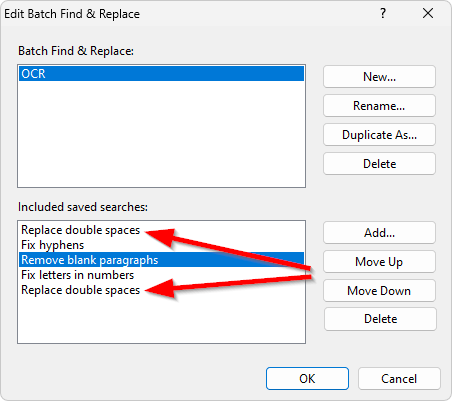

To add a previously saved search to the current batch set, click the "Add..." button. Note that you can add same saved searches multiple times:
Duplicate saved searches

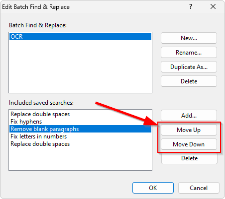

When you launch a batch find & replace, Atlantis performs individual searches from a batch set in the exact order listed in the "Edit Batch Find & Replace" dialog. If the order in which individual items of the batch set are performed is important, you can use the "Move Up" and "Move Down" buttons to reorder the saved searches:
Reordering saved searches
