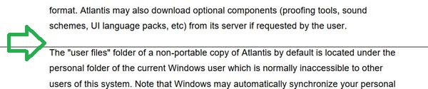

Here are two examples:
Lost Blank Space-1.jpg (30.51 KiB) Viewed 11346 times
Lost Blank Space-2.jpg (17.34 KiB) Viewed 11346 times
If you compare it with the "original" (= uncropped) PDF-file or with the doc-file, you can see that at these spots there should be a blank space.
As mentioned, it depends on the converter if this issue occurs or if the blank space is kept as it should. (E.g. in PDF files created by go4convert.com the blank space is preserved.) Unfortunately the problem occurs with the PDF files created with Atlantis 5. (And it has not to do specifically with SumatraPDF as viewer. The PDFs are displayed in the same way e.g. in the PDF-XChange Editor.)

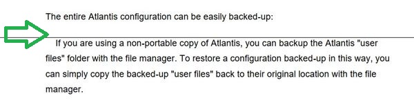

Here are two examples (the typical cases in my documents).
O .... original document (doc-file, respectively rtf-file, created with MS Word)
A .... the pdf-file (created by Atlantis) cropped with the new feature of Atlantis
X .... the pdf-file (created by Atantis) cropped with the PDF-XChange Editor

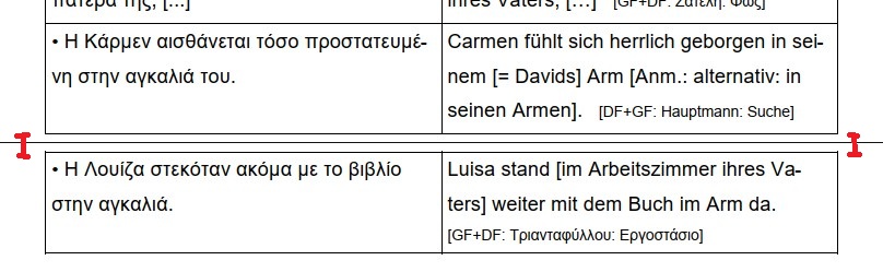

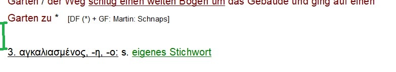

Example 1:
In the original there is no blank line between first and second line but when cropping with Atlantis a blank space is created. With XChange-Editor this is not the case (but I admit that the space seems to be a little bit too small compared with the regular 1,5 lines).
O:
A:
X:

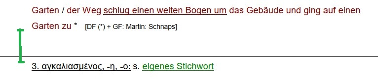

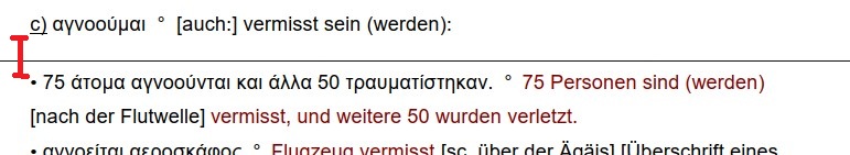

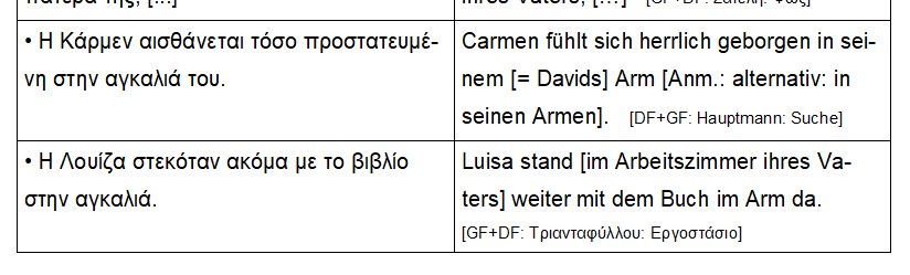

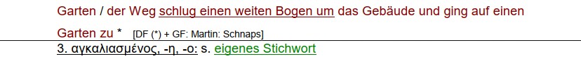

Example 2:
The page break occurs within a table and it coincides with the end of a row. In this case the cropping result with XChange-Editor is visually more pleasant than with Atlantis.
(The same applies when the page break occurs inside a row/cell.)
O:
A:
X:

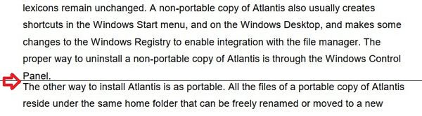

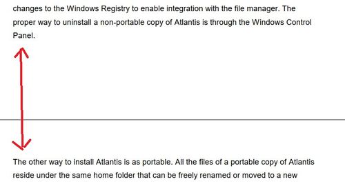

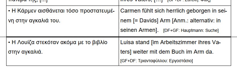

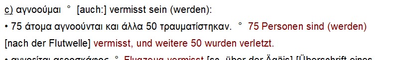

But I am aware that in other cases it is Atlantis that produces the "better" result:
Example 3:
In the following example a page break coincides with a blank line in the original. So the space produced (or preserved?) by Atlantis when cropping is welcome, whereas when cropping with XChange-Editor the desired space gets lost:
O:
A:
X:
I assume that no cropping method can handle all the described cases in an ideal way.
