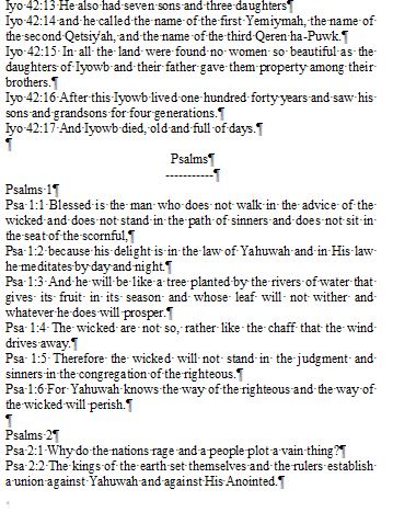

You did not say what exactly are these blank lines. Are there any visible characters within these blank lines besides sheer blanks? You might see line or page break characters within these blank lines if you switch on the display of non-printing characters (View | Special Symbols).Blank lines are added or deleted at random throughout the main body of the document when I close and reopen the document… just blank lines between chapters or books
If these blank lines do not contain any visible characters, and they are pure vertical blanks, they might be the result of spacing after the previous textual paragraph and/or spacing before the next textual paragraph.
If these blank lines are added between chapters or books, this means that they are not added at random. Some of your document or section settings must be causing the blank gaps between chapters or books to be automatically adjusted.

If the added lines only include paragraph end marks (the so-called pilcrow symbol), they are empty paragraphs. These are never automatically added by Atlantis. They are added as you create new (empty) paragraphs by pressing the Enter key or if you paste such empty paragraphs.
Note that these empty paragraphs are usually not visible or noticed unless or until you switch on the display of non-printing characters. So when you close and save an edit in your document, you might very well save one or several of these empty paragraphs without noticing them. But you might become aware of them when you reopen your document.

I don't know if the added lines include the pilcrow marks or not. When I looked at the non-printing characters I had already fixed all of the errors.
That article is interesting, but I'm not sure I understand the significance of it.
Apparently I am not supplosed to hit the enter key to put a space between chapters or books. Is that correct?
Also, why would that randomly create extra lines or delete existing lines?

So if you’re pressing the spacebar multiple times to indent your text or pressing Enter repeatedly to put a gap between paragraphs, you’re wasting effort, misusing your word processing program and, in all likelihood, creating a document with subtly inconsistent spacing which, in turn, makes reading your document less comfortable.
As I said before, I never looked at the non-printing characters in the document when the errors were there. I looked after I had corrected all of them.
I have attached an image of part of the document showing the pilcrows.
- Here is what a part of the document looks like.Tell me what is wrong with it.
- pilcrows-1.jpg (70.18 KiB) Viewed 24598 times
