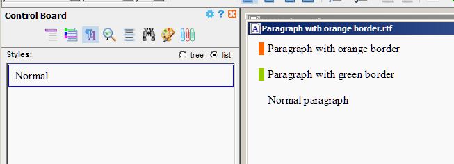

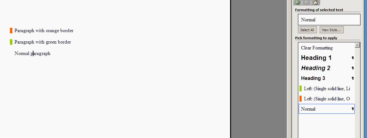

Here are images of what I was trying to say:
Word
Word
AWP
AWP
Re: Paragraph Style display
Atlantis does not automatically add new styles to the document’s style list, at least not when you apply font formatting to the document text. I do not think that Word does either.
MS Word offers a number of options you can use to customize its “Styles” tool. It can display not only the actual styles (permanent styles) stored in the file of the active document, but also styles from the associated document template, recent formatting, etc. Atlantis does not have those Word’s options. But it has the Format Brush and the Format Palette tools. And adding new permanent styles to a document in Atlantis is not hard at all.
