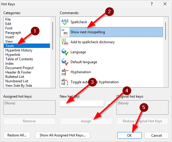

You cannot disable the “No spellchecker is installed” message when you run the “Tools | Spellcheck…” command. But if you assign a keyboard shortcut to the “Show next misspelling” command through the “Tools | Customize | Hot Keys…” dialog:
you can press this shortcut instead of using the “Tools | Spellcheck…” command. In this case, you will not get the “No spellchecker is installed” message.
