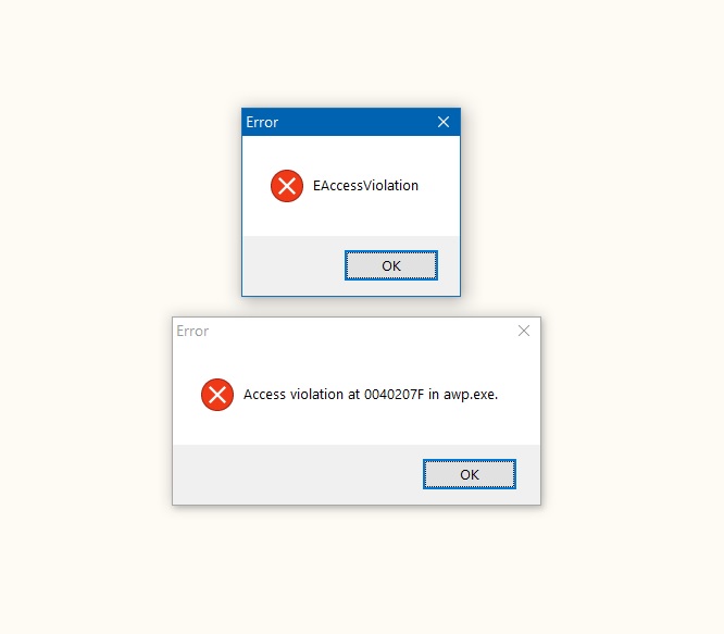

When I clicked yes, it threw another Access violation my way:
"Access violation at 0040207F in awp.exe"
And shut down Atlantis.

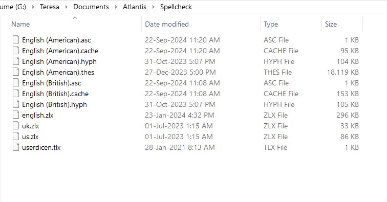

I checked the Spellcheck folder in Atlantis and found the following:

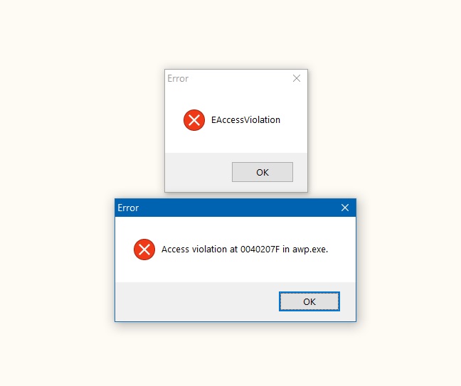

Realizing I hadn't updated recently, I installed the most recent update and this time upon opening, I didn't even get the Error loading the spellcheck dictionary - it just went straight to access violations:

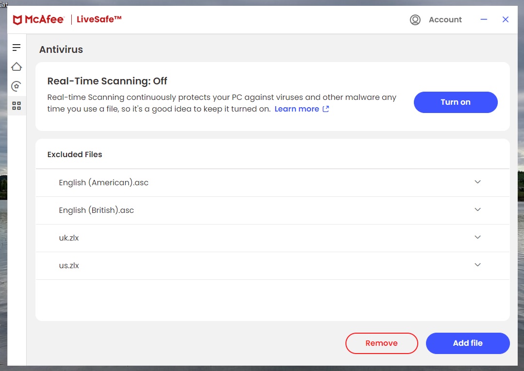

I did that, and it didn't make a difference. Still had the same issue. Added the following files to excluded list in McAfee, rebooted comptuer, still no change:
Posts: 3000
Re: Access violation at 0040207F in awp.exe
The spellcheck files are not executable. There is no point in excluding them. If you need to exclude something, it is the executable file of Atlantis:

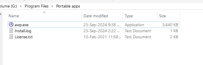

I am sorry, but you did not do this. I suggested to install to a different drive ("C:" for example). You installed to the same "G:" drive. I suggested to install as portable. You did not install as portable because you cannot install as portable to the "Program Files" folder. The entire Help article on portability is a 3-minute read:
https://www.atlantiswordprocessor.com/e ... rtable.htm
OK, if for some reason the "G:" drive is the only available drive in your system, please follow these simple steps:
1. Run the setup file of Atlantis.
2. On the "Choose destination folder" tab of the setup, paste the following text to the edit box:
G:\Portable apps\Atlantis
and check the "Install as portable" box.
3. Complete the install. This would create a new clean portable copy of Atlantis.
Run the "awp.exe" file from "G:\Portable apps\Atlantis" to launch this portable copy.
Another suggestion. Open the "G\Teresa\Documents\Atlantis" folder with the file manager, and rename the "Spellcheck" folder to anything else (for instance, "_Spellcheck"). Then run your standard copy of Atlantis by double-clicking the Atlantis Desktop shortcut.

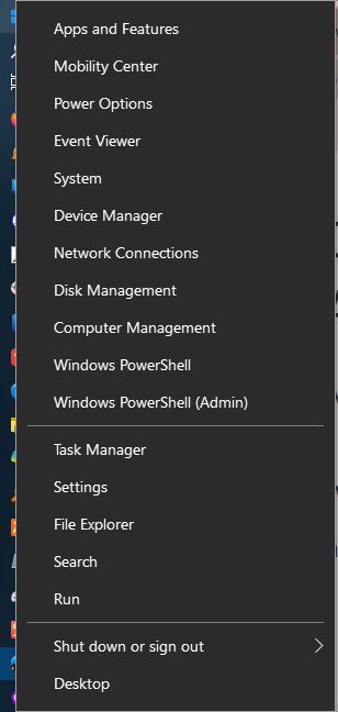

I don't have that option on my Win10 Pro Start Button menu
