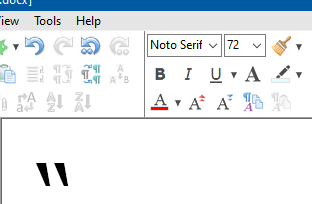

The character is a Reversed Double Prime (hex 2036). I did not update this book after finding out that the Noto Serif font doesn't have this character and having developed a search & replace to fix the blank space that was displayed, which is why this happened now. What threw me off was having a character displayed. I can recreate this by typing in a Noto Sans Reversed Double Prime and then changing the font to Noto Serif. If I do the same for the Double Prime it will display in serif the Quote Mark looking character of the serif font, not an angled prime I am used to.
What is the reason it now shows a Reversed Double Prime in Noto Serif (I have not changed or updated the font) when previously it showed a blank space?

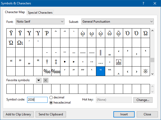

As can be seen in the Atlantis own Character Map, The Noto Sans font includes glyphs for U+02BA, U+2033, U+2036, but has no glyphs for U+301E or U+301F. Atlantis offers to substitute the corresponding glyphs found in Arial Unicode MS.
Same thing with the Noto Serif font itself. It includes glyphs for U+02BA, U+2033, U+2036, but it has no glyphs for U+301E or U+301F. Atlantis offers to substitute the glyphs found in Arial Unicode MS.
HTH

Atlantis 4.3.4.0 beta a3 finds U+2036 in "Noto Serif":
U+2036 can be inserted into an Atlantis document:
Now if I go to Noto Serif - Google Fonts, and paste U+2036, only the italic character previews display a REVERSED DOUBLE PRIME glyph.
HTH

Posts: 3000
Re: How can I find the character code for a letter?
Alan wrote: What is the reason it now shows a Reversed Double Prime in Noto Serif (I have not changed or updated the font) when previously it showed a blank space?
You can test this under a different text rendering method ("Tools | Options... > Accessibility"). GDI and DirectWrite may do font substitution differently.

Post by Alan »
Thank you admin,
My text rendering was set to Direct Write with Clear Type antialiasing. When I set it to any of the 3 GDI I saw the open rectangle, meaning undefined character, which is what I expect to be displayed nowadays. I am now pleased to have the latest Noto Serif installed and displaying both prime and reversed prime characters.
Alan

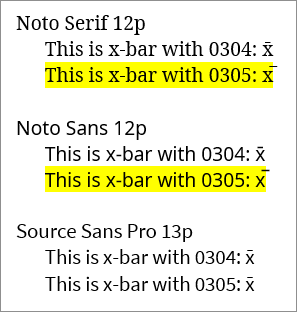

The x-bar glyph
A number of years ago I needed to help someone with "basic" statistics (actually, "basic" was pretty difficult :? ).
I could never find a font that had an "x-bar" glyph, which is an 'x' with a macron directly over it. It represents a "sample mean" in statistics. Years later I discovered that you could make the x-bar with an 'x' and a combining diacritical macron. However, this may not work with certain fonts, even if they have the macron diacritical; I do not know.
Anyway, it is possible to make the x-bar with Atlantis. At least, it is possible to make it with certain fonts and with certain macron glyphs. But two problems arise. I will go over these individually. It is really the second problem that is the greater one.
1. Some macrons do not work.
Consider the following three fonts, which I use in an attempt to create the x-bar with two different diacriticals: the short macron (hex 0304) and the overline (hex 0305). Here is how Atlantis handles these, and how LibreOffice Writer handles them.
ATLANTIS

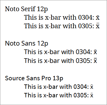

LIBREOFFICE WRITER

If you save a file and close Atlantis, then re-open Atlantis, you discover that the x-bar glyphs have undergone a destructive change. All of the macron/overline diacriticals have been converted to hex 00AF, which is another macron, but it is not over the 'x' anymore. Here is what you have when you re-open the file:
ATLANTIS (After you re-start Atlantis)

I wanted to bring this to your attention. Maybe these issues are fixable.
I am using the very latest beta of Atlantis. My operating system (yes, it is old) is Windows 7.
Hi Roland,
If I type the “x” letter first, follow through with the code for the combining macron (0304), and press Alt+X, I get a proper x bar symbol in latest 4.3.4 Atlantis release under factory settings.
See attached “X Bar Symbol.docx” whose x bar glyphs survived closing and reopening of that document, including after shutting down Atlantis.
This is in Windows 10 Home 64-bit.
X Bar Symbol.docx
(3.64 KiB) Downloaded 2562 times
Windows 10 Home 64-bit. Atlantis 4.3.4.1 beta a0 under factory settings.
Here is how “X-bar_Issue.docx” is displaying on my system:
As you can see, the overbar is displaying directly over the 'x'.
Have you tried opening “X-bar_Issue.docx” under factory settings?
