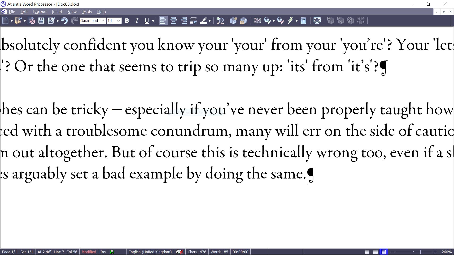

Using my 15 inch laptop, I frequently enlarge the font size by pressing control and using the mouse wheel (forward) to zoom in to a size the suits better my poor vision. However, when I increase past 200 %, the text starts to disappear on both sides of the screen - left and right. Is it possible to correct this?

Please see the attachments.
- Screen shot at 200 % and 250%.

Thanks for the screen captures. As far as I can see, everything displays as expected. The document window is not wide enough to accommodate the document page under 260% zoom. You have the "Print layout" mode enabled under the "View" menu. And as I understand, the horizontal scrollbar is off on your system (the "View | Scrollbars | Horizontal" command of the main menu). You might wish to enable the scrollbar, or switch to the "View | Draft (Wrap to Window)" mode.
Posts: 3000
You can also scroll the document window without the scrollbars if you press and hold the mouse wheel, and move the mouse pointer in required direction.

Thank you very much for your suggestions. Wrap to Window mode solved my problem.
