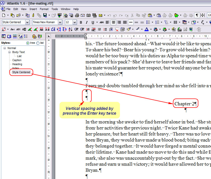

Hi Alex,
I have had a look at the Smashwords Style Guide (http://www.smashwords.com/books/downloa ... -guide.rtf).
Things are actually very straightforward: you need to keep your source document as simple as possible. Concentrate on content, avoid using fancy font or paragraph formatting, keep the layout as simple as possible. Have a look at the sample RTF documents available from the Smashwords site, in particular at “the-mating.rtf” (https://www.smashwords.com/books/downlo ... mating.rtf). It is formatted in the simplest way, almost as if it has been created in a pure text editor.
You can achieve the same formatting (or absence of formatting) in Atlantis. Simply start typing a paragraph in. When you have finished, press the Enter key. Type another paragraph in. And so on.
When you feel the need to add some vertical spacing, press the Enter key twice instead of once between paragraphs.
If you have chapter titles, associate the corresponding paragraphs with an appropriate style. In “the-mating.rtf” sample file, the chapter headings are centered and are naturally associated with a style whose properties include a centered alignment for the associated paragraphs (see screen capture below).
Since page breaks are not used in the Smashwords sample documents, you’ll probably be safer avoiding them too. So do not press “Ctrl+Enter” to create manual page breaks. Keep your text freely flowing from one paragraph to the next. This is why it is preferable to use the Atlantis “Draft View” to create such documents. This viewing mode (“View | Draft”) ignores document “pages” as such. You will be able to concentrate on the free flow of text. The page breaks, if any, will be added by the Smashwords converter.
- Style Centered.jpg (302.4 KiB) Viewed 12449 times

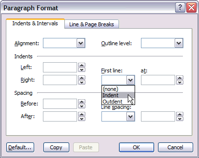

Here is how I would go about this. Don’t panic, it is actually a lot more simple than it looks!
1. Open Atlantis.
2. Pull the drop-down attached to the Clippy Bank green icon, and click to check the “Collect Plain Text” option (see screen capture below).
3. Click the Clippy Bank green icon itself to activate the “Clippy Bank collects clipboard data” mode (see screen capture below).
4. Press “Ctrl+Alt+F8” to empty the Clippy Bank if it isn’t empty.
4. Open your DOC file in Atlantis.
5. Press Ctrl+A to select the whole document.
6. Press Ctrl+C to copy that whole selection to the Windows clipboard, and send it automatically to the Atlantis Clippy Bank as pure text.
7. Press F8 to open the Atlantis Clippy Bank if it isn’t already displaying.
8. Press “F12” to save the Clippy Bank contents as a “.doc” file.
9. Press “Ctrl+O”, and open the file you just saved.
10. Click the Clippy Bank green icon again to deactivate the “Clippy Bank collects clipboard data” mode. I assume you don’t need this mode any longer.
10. Press “F6” to display the Atlantis Control Board if it isn’t already displaying.
11. Click to display the Control Board “Styles” panel.
12. Select the “Normal” style.
13. On the toolbar at the bottom of the “Styles” panel, click the second icon from the left to open the “Edit Style” dialog.
14. In the “Edit Style” dialog, press the “Paragraph” button.
15. In the “Paragraph Format” dialog, pull the drop-down attached to the “First Line” box, and click to select “Indent”. This will set a default first line indent for all the document paragraphs associated with the “Normal” style (currently all its paragraphs). Note that as I understand things only first line indents are accepted by the Smashwords “Meatgrinder”. Do not specify any other type of paragraph indent.
16. OK out of all dialogs to validate your changes.
17. In the “Styles” panel, select the “Heading 1” style.
18. On the toolbar at the bottom of the “Styles” panel, click the second icon from the left to open the “Edit Style” dialog.
19. In the “Edit Style” dialog, press the “Paragraph” button.
20. In the “Paragraph Format” dialog, pull the drop-down attached to the “Alignment” box, and click to select “Centered”. This will set a default centered alignment for all the document paragraphs associated with the “Heading 1” style (currently none of its paragraphs). OK out of the “Paragraph Format” dialog.
21. Still in the “Edit Style” dialog, click in the “Hot Key” box. Type any suitable hot key. You will use this hot key to associate any target paragraph with the “Heading 1” style in a handy way.
21. OK out of all dialogs to validate your changes.
22. Now you need to associate all the document headings with the “Heading 1” style. This has to be done manually. If your document headings are chapter titles, and they all start with “Chapter”, it will be easy to navigate to each of them, maybe even to select all of them (use the Ctrl+F” dialog). If your document headings have different captions, you’ll have to locate each of them manually.
23. In any case, you can associate the document headings with the “Heading 1” style by clicking within the heading and pressing the hot key you assigned to the “Heading 1” style. Associating a paragraph with the “Heading 1” style will automatically center it since you defined this to be a property of that style.
Of course, this is all suggested rather abstractedly. We could make more adequate suggestions if you sent your document, or part of it to contact@AtlantisWordProcessor.com. We will respect your privacy in every way.

- First Line Indent.png (8.95 KiB) Viewed 12427 times
- Collect Clipboard Data.png (2.34 KiB) Viewed 12427 times
- Collect Plain Text.png (1.84 KiB) Viewed 12427 times
