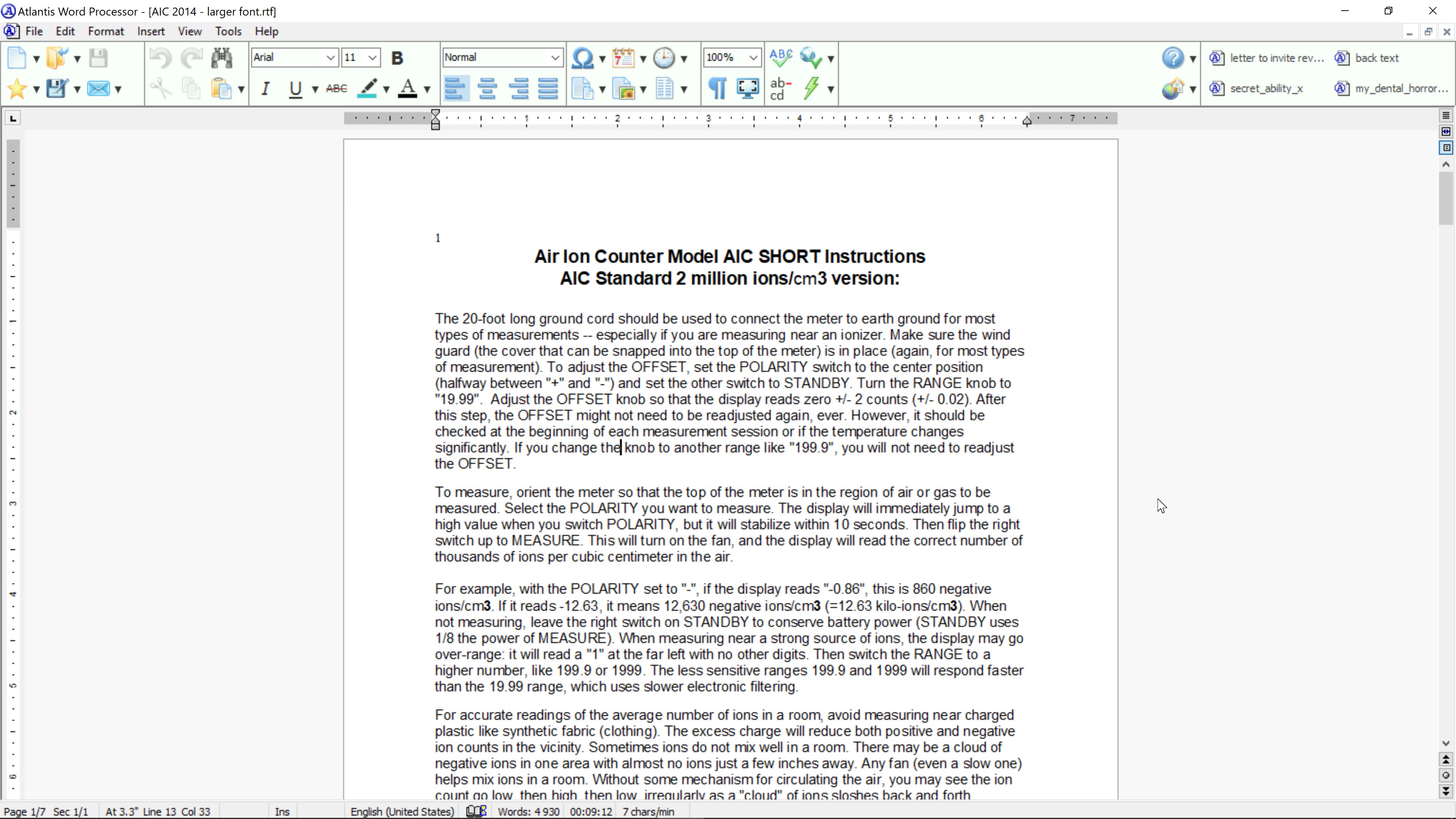

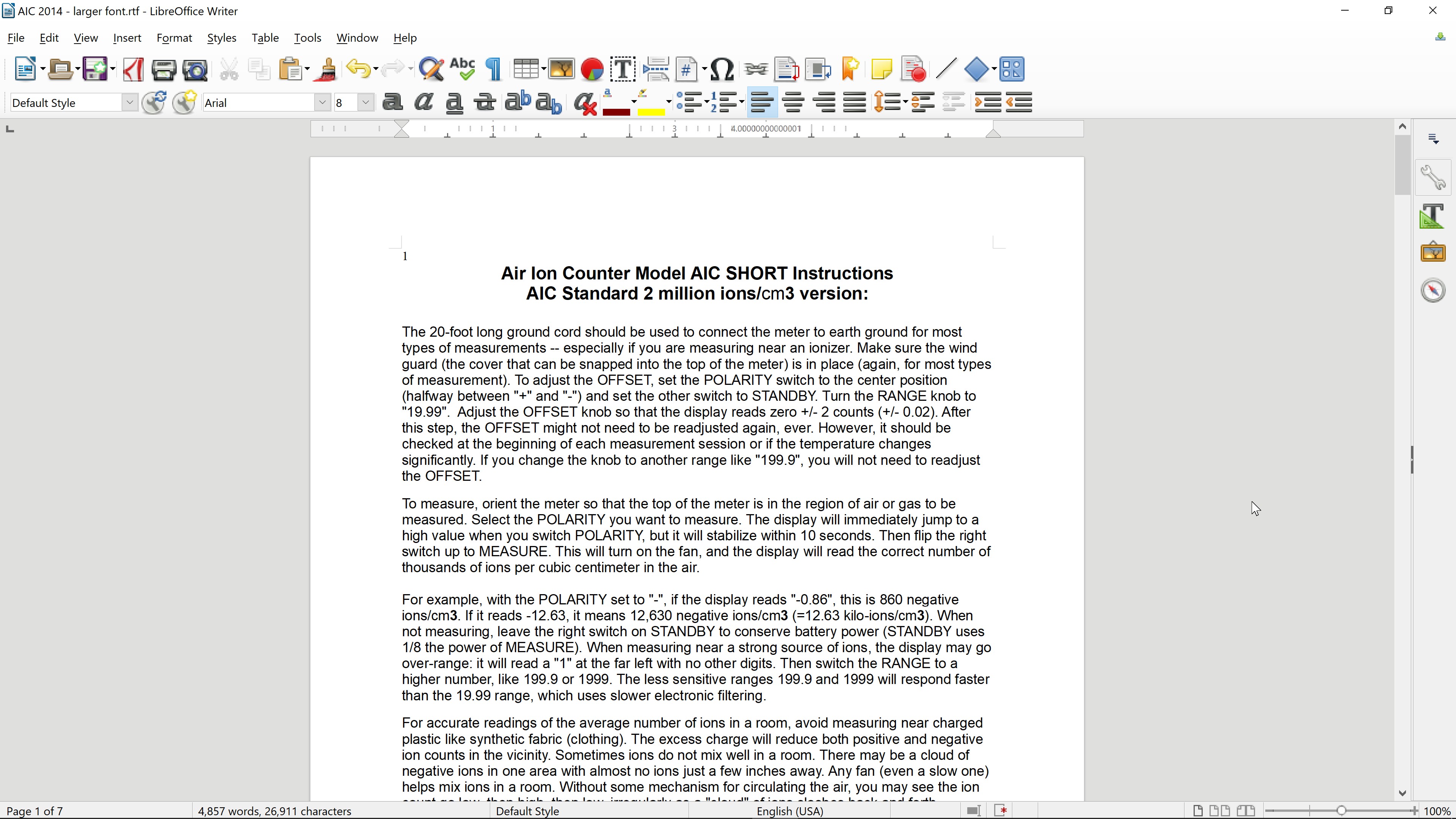

My biggest issue is resolution. Interface and Fonts are not crisp on a 4K laptop.
I've attached screen shots of the same document on Atlantis 3.1 vs Libreoffice Writer. Libreoffice is much crisper - fonts and icons.
Sorry the files are so large...I wanted to show the original screen capture without compression.
4k - libreoffice.jpg (1.11 MiB) Viewed 12932 times
4k - atlantis 3-1.jpg (956.78 KiB) Viewed 12932 times

You could try running Atlantis in some form of Compatibility Mode. Have a look at the tricks suggested for Windows Desktop Applications at Blurry apps ruining your 4K monitor? Adjust high-DPI scaling in Windows 10
A similar trick is explained at Override System DPI Scaling for an Application with Blurry Fonts
Also here is from How-To Fix Fuzzy Windows 10 Text on High Resolution Displays
There is a workaround that you can use. Right-click on the shortcut of the app you’re having an issue with and then Properties. Then select the Compatibility tab and enable ‘Disable display scaling on high DPI settings.’ A restart will be required to finish the process.
Posts: 3000
Version 3.2.2 will be probably DPI-aware.
