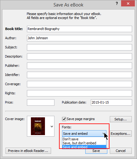

Note that you need to activate the “Save & Embed” option before saving a document as eBook:

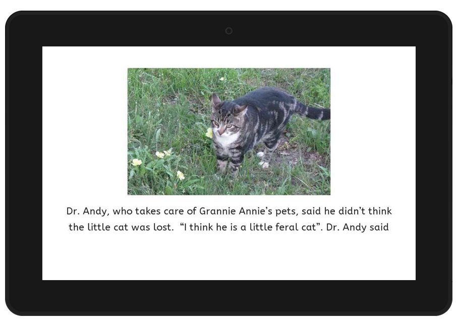

I'll attach a screen shot -- a page from Matt the Cat Finds his Person, with font Abeezee embedded with Atlantis Word Processor.
