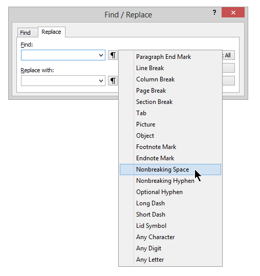

Finally, you might inherit nonbreaking spaces through copy/paste from other applications. In this case, if you still want to get rid of these nonbreaking spaces, you need to use the Atlantis “Find / Replace” dialog.
1. Press “Ctrl+Home” to bring the insertion cursor to the beginning of the document.
2. Press “Ctrl+H” to open the “Find / Replace” dialog.
3. Clear the “Find” box if necessary, and leave the blinking cursor within the “Find” box.
4. Press the small button to the right of the “Find” box.
5. In the pop-up menu, click “Nonbreaking Space”:

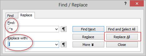

6. Clear the “Replace with” box if necessary, and leave the blinking cursor within the “Replace with” box.
7. Press the space bar to enter a space character into the “Replace with” box.
8. Press the “Replace All” button:
Atlantis will turn all nonbreaking spaces into ordinary “breaking” spaces.
