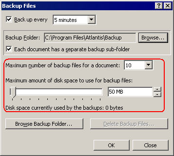

I notice I'm still getting a pause sometimes when I resume work in Atlantis but after spotting the occasional 'backing up' message and/or the little green floppy disk icon at the bottom of the window, I'm now wondering if it's got more to do with Atlantis saving and backing up than anything else? In Options, Load/Save I have 'Safeguard' set to 3 minutes and 'Backup Files' set to 15 minutes.
So, I'm guessing that when I minimise Atlantis then, later, maximise it and start typing, the first thing it does is notice it's overdue to do a save or 'safeguard' and spends a few seconds doing that. Does this sound feasible?
If so, perhaps you could amend it so it doesn't immediately save after being maximised and/or the user starts typing? I'd rather sacrifice the occasional backup (or delay it) than get the pause each time, just when I'm trying to get something down before it evaporates.

A backup copy of a document is made by Atlantis when you make a change to this document, and the requested amount of time ("Tools | Options... > Load/Save > Backup Files... > Backup every N minute") has elapsed. Your document must be quite long if Atlantis stops responding for a few seconds.andygrunt wrote:I notice I'm still getting a pause sometimes when I resume work in Atlantis but after spotting the occasional 'backing up' message and/or the little green floppy disk icon at the bottom of the window, I'm now wondering if it's got more to do with Atlantis saving and backing up than anything else? In Options, Load/Save I have 'Safeguard' set to 3 minutes and 'Backup Files' set to 15 minutes.
I am not sure that delaying a backup would improve anything.
I suppose your Atlantis is configured to make backups "too often" on your system. Just instruct Atlantis to make backups less often (adjust the "Tools | Options... > Load/Save > Backup Files... > Backup every N minute" setting).... I'd rather sacrifice the occasional backup ...
Another note. If the Backup folder of your Atlantis contains too many files, this might slow down backup creation. Please open the "Tools | Options... > Load/Save > Backup Files..." window of Atlantis, and click the "Browse Backup Folder..." button. Most probably you will find there plenty of subfolders with backups for various temporary/draft documents. If you do not need them, just remove entire folders with backups of individual documents. Alternatively please click the "Delete Backup Files..." button of the "Tools | Options... > Load/Save > Backup Files..." window, and remove spare backups.
By the way, you can use the following two options of the "Backup Files" dialog to control the performance of backup creation:
The less "max number of backups per document" and disk space for backups the faster backup creation.
I'm pretty sure it's not quite acting that way.admin wrote: A backup copy of a document is made by Atlantis when you make a change to this document, and the requested amount of time ("Tools | Options... > Load/Save > Backup Files... > Backup every N minute") has elapsed.
I usually have 2 or 3 docs open at a time, most of them just a few pages long. The main one that's always open is bigger (773 Kilobytes) but I wouldn't have thought that counts as huge. Saving it doesn't seem to take very long i.e. the progress bar zips across in about half a second or less but I'm not sure if that's the complete extent of the saving progress or not (i.e. whether it does other stuff before or after the progress bar appears).
I'm in the habit of manually saving (CTRL+S) very often - after each sentence or two. I got into this habit as Atlantis occasionally (once a month ish) crashes on me (although it's rare to lose data). I certainly never minimise Atlantis without saving the doc I'm working on and yet, when I come back to it after doing something else, I often notice the doc gets saved immediately before I can start typing. I presume that it shouldn't save if there's been no changes to the doc and yet that's what often seems to be happening.
I'll try changing the save settings you mentioned and see if that helps although I'm puzzled why the number of saved files or the space used on the hard disk would affect how long an individual save would take. My current 'Backup Files' settings (in case it's of interest) are: save every 15 minutes, Max number of backup files for a document is 4 and the max amount of disk space to use for backup files is 200Mb (disk space currently used by the backups is 139.05Mb).
