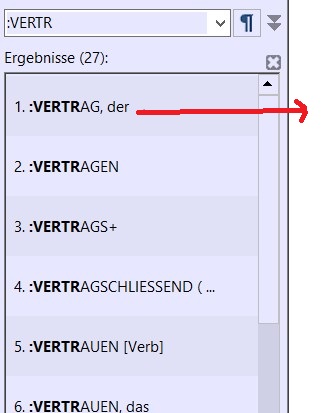

An example:
- When I type "VERTR" into the "Find what-Box" the first word in my document beginning with these letters (= VERTRAG) would be visible already in the document window.
- When I continue typing "VERTRAGE" there would again be performed a jump to the first matching word in the document window (= VERTRAGEN), and so on.

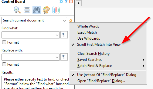

Please check the new version 5.0.1.4. The “hover” previews are now canceled after a delay, and there is a new “Scroll first match into view” option in the “Find/Replace” panel:
