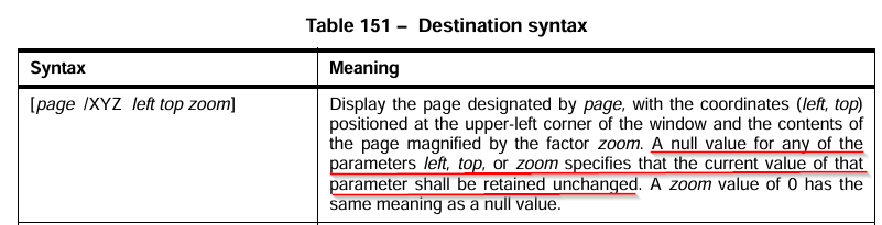

In both PDFs, the following syntax is used for hyperlink destinations:
[page /XYZ left top zoom]
Unlike go4convert, Atlantis specifies “null” for “left” meaning that the PDF reader does not need to scroll its window in horizontal direction when the person clicks the link. This seems to confuse SumatraPDF. Here is an excerpt from the PDF specification:
There is nothing wrong with the links generated by Atlantis. This seems to be an issue with SumatraPDF (incomplete implementation of the Destination syntax).

SumatraPDF seems to be the only PDF reader that does not support null values within the link (annotation) destinations. If you care about this PDF reader, you can report the issue to its developers. I am sure it is very easy to fix.

This is a SumatraPDF-specific issue. This PDF reader does not completely follow the PDF specification regarding annotation destinations.

But at any rate SumatraPDF is not the only PDF-reader with this problem.
As I tried to explain, Atlantis generates proper link (annotation) destinations according to the PDF specification.
