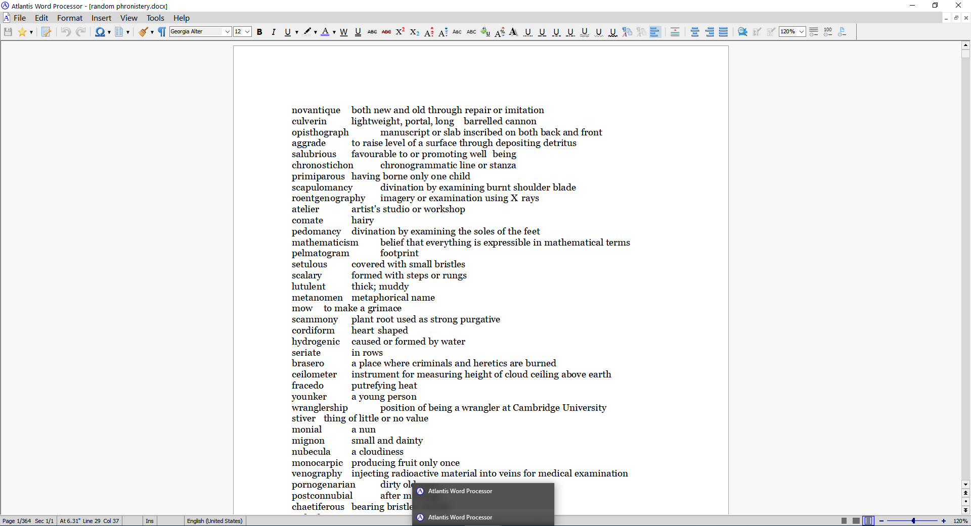

Modal or not modal, is there any open dialog in the existent instance of Atlantis when this happens? Which dialog (screen capture if at all possible)?
Taking place consistently right now, with no dialog present.
2021-10-29 02_29_11-Window.png (63.17 KiB) Viewed 16382 times

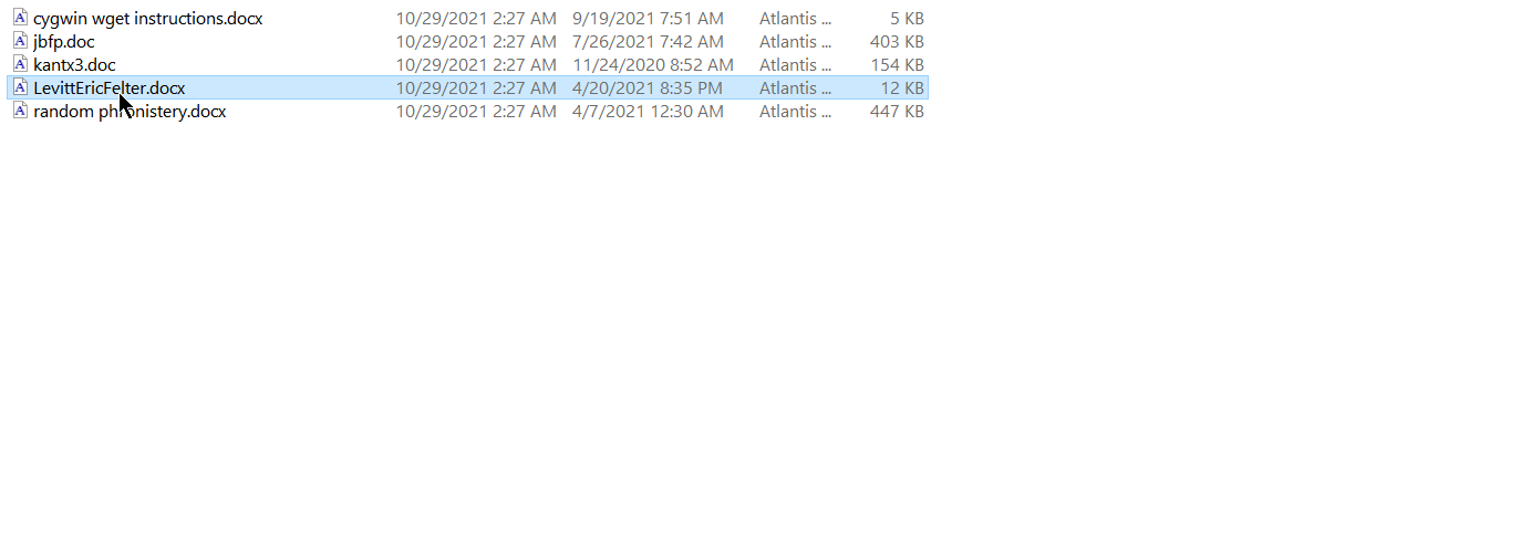

Any file opens up a new Atlantis
2021-10-29 02_29_52-New folder.png (16.98 KiB) Viewed 16382 times
2nd instanced:
2021-10-29 02_33_02-Greenshot.png (90.88 KiB) Viewed 16382 times
As can be seen I tried it with the control board closed in the existing instance too. Weird stuff!

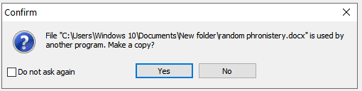

With files that aren't just empty docs it'll ask this when opening the new instance:
2021-10-29 02_36_09-Atlantis Word Processor.png (6.68 KiB) Viewed 16382 times
