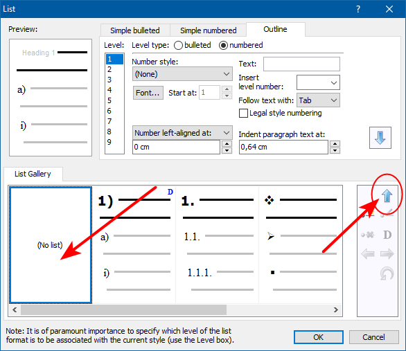

Re: Tiny arrows at the first of each heading
Where will I find the place to do this?
Here are the steps:
1. Click “Format | Style…”
2. In the “Style” dialog, select the “Heading 1” style.
3. Click the “Modify…” button.
4. In the “Edit Style” dialog, click the “List…” button.
5. In the “List” dialog, click to select the (No list) button, and click the Up arrow button to load the highlighted (No list) format:
6. OK out of all open dialogs.
7. Repeat same steps with the “Heading 2” and “Heading 3” styles.

Robert, Yes that worked. Thank you.
