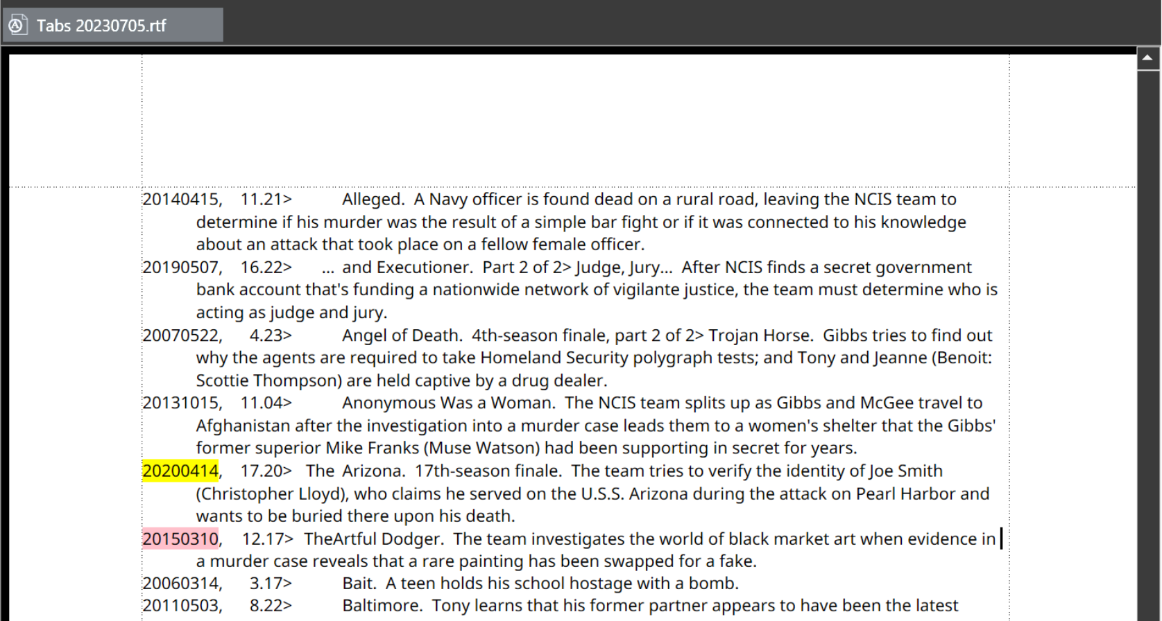

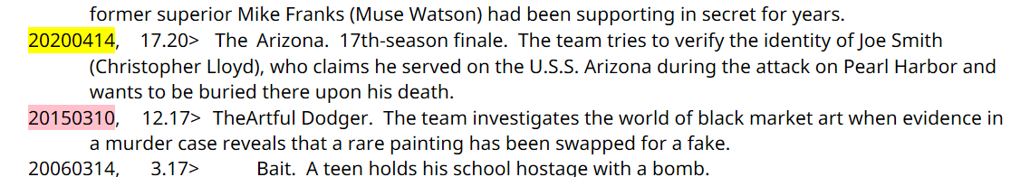

I have attached the file with 1 example. The previous behavior shown with the paragraph highlighted in yellow at the beginning and with episode title The Arizona looks correct with a short gap caused by a tab between The and Arizona. The next paragraph with the beginning pink highlight has no gap between The and Artful Dodger when I expected it to have one. This is one example of my attempts to change the gap width to accommodate the new font I am using (Noto Sans). All the episode paragraphs have 2 tabs used to form the episode title with the alignment I want.

On my systems, your document displays in this way:
Note that the tab stop positions are not the same for the whole document. You can use the Reveal formatting panel of the Control Board to examine the tab formatting.
Re: Tab behavior under 4.3 changed
Your system is working like I expected mine to work. I deliberately put the revised paragraph style after the pre-4.3 style to show how it looked before changing a paragraph style slightly to improve the look, that is when the space disappeared. I have attached a Snip to show how it looks on my computer. Is there anything I can look at to help determine why a changed paragraph style does not render properly on my computer? A Ctrl+z will revert a paragraph style change back to looking correct.

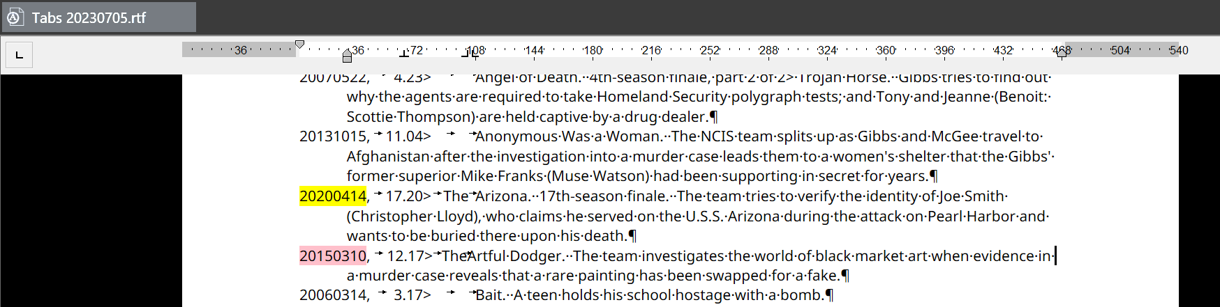

I have attached a new Snip with what you wanted. Both are of that same file as you have.
I think it is the latest Beta (it is a9) though it has been a couple of days since I checked for an update.

To make the special symbols visible in Atlantis, you should enable the “View | Special Symbols” mode. Also there is no horizontal ruler with the tab stop marks on your above screen capture.
Have you tried switching to a different rendering mode (the new option on the “General” tab of the “Tools | Options...” dialog)? Does it make any difference?

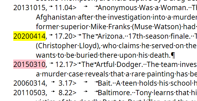

Todays attached Snip now has the ruler and special symbols showing. The insert point is in the mal-displaying paragraph (at the end of the first line) so the ruler is showing that paragraph's tabs.
Running under Factory Settings does not change the tab display, it is still wrong for one paragraph.
I have not tried changing the rendering mode. I will play with it later when I have some free time.

Installed your fonts. No change on my system. So it is not about the font version.
What is your Windows text size? Is it 225%?
Finally reproduced this after setting "text size" to 225%. Fixed in the latest build of 4.3.2 (beta). Please check for updates. Thanks.

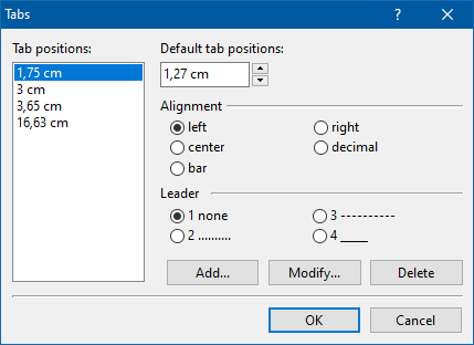

I have created a document exemplifying the rational use of tab stops and tab characters. See attached "Tab Behavior.rtf".
If you press Ctrl+A, then bring up the "Tabs" dialog ("Format | Tabs…"), you'll see the left-aligned tab stop values:
If you look at the alignment of each tab stop, you'll see that each has a simple basic left alignment. All the tab stops are positioned from left to right as is the text in your document. They make sure that a press on the tab key will align your text vertically as expected.
In other words, your document original tab formatting is overly complicated. It contains a mix of left, right, and decimal tab stops. There is no need for this. Left-aligned tab stops are all that you need to achieve the vertical columnar alignment that you want.
