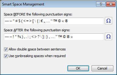

The culprit, for me at least, is the Auto-correct option 'Replace "quotes" with " ". Deselecting gets rid of the issue, but of course also gets rid of the nice curly quotation marks in favour of boring straight ones!
Re: Latest update
You do not need to uncheck the "Replace quotes..." option. Please click the "Rules..." button of the "Tools | AutoCorrect Options..." dialog, delete the contents of the first edit box, and paste the following text instead:
Then clear the second edit box, and paste the following text:
OK out of the open dialogs.
This is how this dialog is supposed to look by default:
