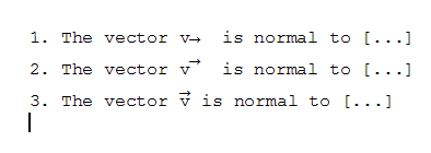

Hi kitimat,
You can achieve something similar to an overbar by using character formatting.
(See the attached image)
1. The arrow and "v" are adjacent, with two spaces after the arrow.
2. I raised the arrow by 6 pt.
3. I selected the "v" and arrow, and compressed the spacing by -6 pt. This stacks them on top of each other.
