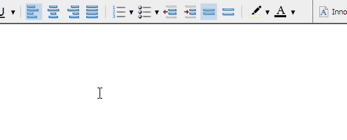

I don't find this to be the case (see GIF).If Atlantis slowly responses to the AHK's keystrokes on your system, there should be same delay in case with standard key presses.
Without pictures AHK is slower in AWP than it is in other programs. Pictures in Square or Tight format drastically increase this effect.If having a floating picture in the document is a necessary condition to reproduce the delays, this whole issue is unrelated to AHK.
I was using Draft view all along. Print view is faster, except on the page where the Square layout image is. This perhaps suggests a pagination issue.By the way, did you try using Atlantis under the Draft view?[/code]

- "Slow" AHK file with Square image layout, Draft view
- GAPW5.gif (87.46 KiB) Viewed 13955 times
According to your GIF animation, Atlantis treats your key presses and the key presses synthesized by AHK identically slowly: your typed characters do not get inserted to the document faster than the characters generated by AHK. Actually, it is irrelevant to Atlantis how exactly a given keystroke was generated.
