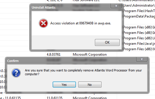

Wow. Just wow.
After the clean install of Atlantis, getting everything configured, backing up the .ini file, etc., I then sought to uninstall Atlantis. As soon as I did, I got an access violation just trying to uninstall the program...
I'm saying, there is something wrong. Why would it give an access violation upon uninstallation? This is v4.1.3.4.
- access_violation.png (33.54 KiB) Viewed 33143 times

First thing that came to my mind was "why on earth would anybody want to uninstall an application immediately after having just installed, and configured it?"patr wrote:I've emailed the .ini file to you. To note, this .ini file is based on a clean install of Atlantis; I then configured the application as I wanted and saved the .ini file. I then uninstalled Atlantis and this is when the access violation error occurred.
But it obviously can be done. So why not do it? If only to make a point!
Now your screen capture seems to imply that you tried to uninstall Atlantis when there was still an instance of Atlantis running on your system: the 2 dialogs in your screen capture are spawned by Atlantis, and the access violation can only happen if there is a running instance of Atlantis.
I did not have Windows 7 to test this. I tested it in Windows 10 (with all latest updates). I left Atlantis running and tried to remove it through the standard Windows procedure. This is most unadvisable. But obviously, some people will inevitably try to do it.
So I went ahead with the uninstall. I got this:
I closed the running instance of Atlantis 4.1.3.4, and clicked on the Uninstall button again. I got this:
So it was impossible for me to uninstall Atlantis without closing any running instance of Atlantis first. How was it possible for you? It baffles me!
I clicked on the “Yes” button in the above dialog and got this:
No access violation!

I also just explained that uninstalling Atlantis calls awp.exe into action, so again you're off regarding the issue at hand.
I can do what you did above as well (installing, uninstalling, etc). I just did it ten times. This thread is not about when it works as it should. It is about when it doesn't. And why it throws access violation errors in various scenarios, however un-reproducable we might find them. Programmatic errors often don't manifest on schedule, you know.
I think it is more helpful if we whittle down the useless responses of which there have been enough now, and try to figure out why those access violation errors occur.
