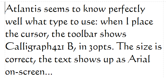

Atlantis seems to know perfectly well what type to use: when I place the cursor, the toolbar shows Calligraph421 B, in 30pts. The size is correct, the text shows up as Arial on-screen...admin wrote:What typeface is reported by the Atlantis toolbars when you click your "Arial" text?
It would be good if your provided more details. A screenshot of the Atlantis window with your document might be helpful.
To be clear: if I select the text and re-apply the font, everything is well. But I don't want to re-apply formatting, section by section, on a 600 page doc!
I just don't understand why this is happening at all, for the first time since I've owned Atlantis.

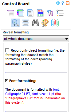

I downloaded “Calligraph421 BT - .TTF ” from Calligraph421 BT font and installed it on my Windows 10 system.
I created attached “Calligraph.docx” in latest Atlantis. It looked this way:
I then uninstalled the Calligraph421 BT font from my Windows 10 system.
I reopened “Calligraph.docx” in latest Atlantis. It looked that way:
Most likely, if Atlantis uses Arial to display the Calligraph421 BT font, it means that the Calligraph421 BT font is not actually installed on your system.
Note that fonts can be installed for the current user or for all users in Windows 10. Make sure that the Calligraph421 BT font is installed, and installed for the current user when you use Atlantis.

Robert wrote:I downloaded “Calligraph421 BT - .TTF ” from Calligraph421 BT font and installed it on my Windows 10 system.
“TT1139M_.ttf” as available from Calligraphic 421 Roman has characters that look very much like those of “Calligraph421 BT font”.
Are you sure that your document is using “Calligraph421 BT font”, and not “Calligraphic 421 Roman”? The font name would look almost identical on the Atlantis toolbar…

Have a look at this picture.I do not recall having to choose whether the font was only for the current user or for everybody.
You’ll see that you can install a font for the current user or “for all users”.
The pull-down menu clearly shows "Calligraph421 BT" (without the quotation marks, of course) - I hope I understood your question . . .Robert wrote:“TT1139M_.ttf” as available from Calligraphic 421 Roman has characters that look very much like those of “Calligraph421 BT font”.
