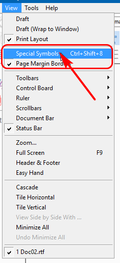

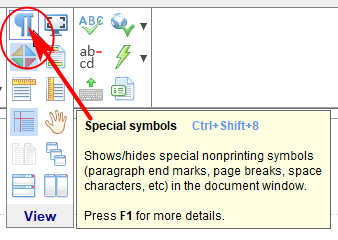

Have you tried to click on the following button on the View toolbar:
You could also use this main menu command or the associated hot key:
lynneconnolly
Posts: 76
Joined: Tue Aug 08, 2017 7:44 am
Post by lynneconnolly »
Yes, of course I have! Nothing. No response, the text doesn't change. I've tried it with different documents, all the views (draft, draft wrapped, page). All nothing.

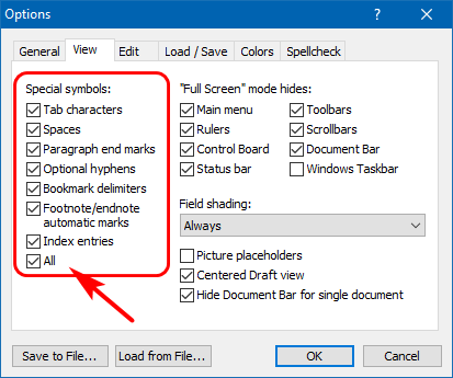

You should see them with the above commands. But you also need the relevant boxes to be ticked in the following dialog (Tools | Options… > View tab):
lynneconnolly
Posts: 76
They're all ticked already.
