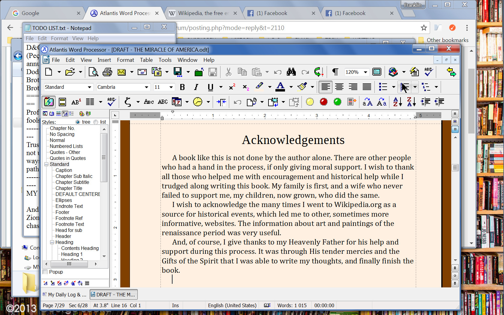

Here is the first screenshot with Atlantis loaded properly.

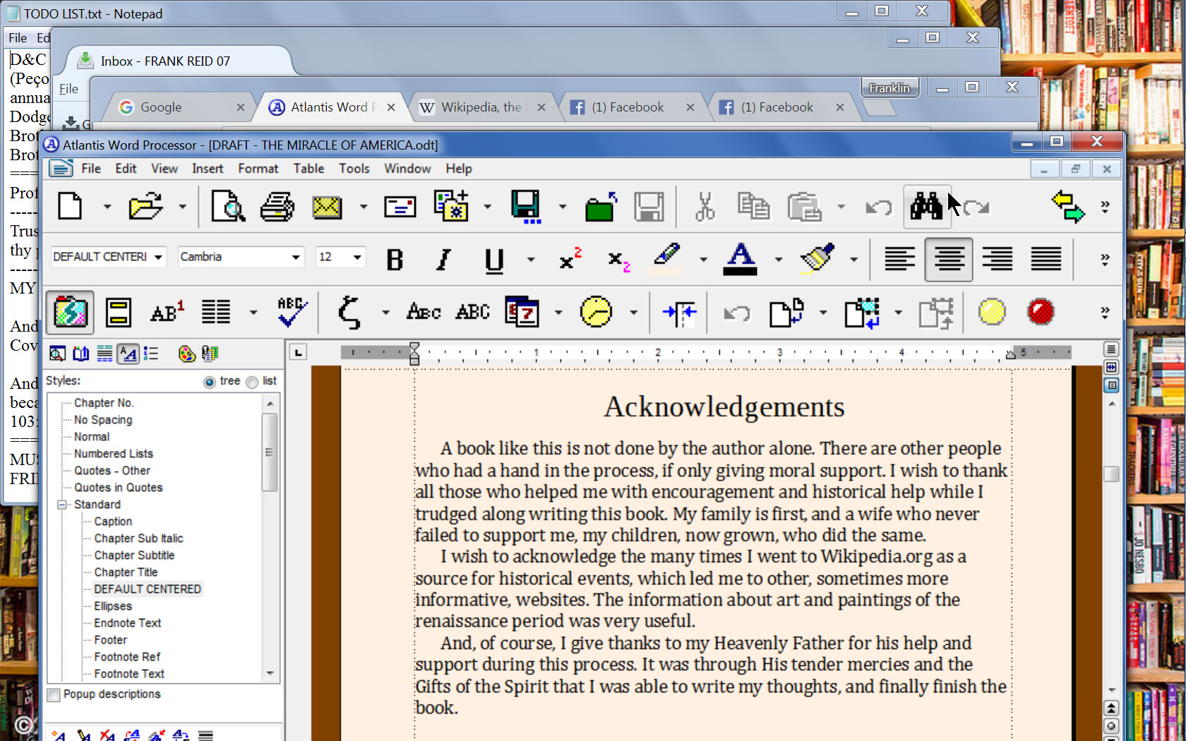

Here is the same or similar screenshot after closing the Atlantis program then restarting it from any of the sources; desktop icon, Atlantis folder, Menu Bar, taskbar.

As you see, both shots show the programs behind Atlantis are sharp and crisp. The first one shows Atlantis as it loads the first time when turning on the machine. The second shows the same programs behind, still very sharp but when I open Atlantis again it is in a low-resolution mode. Why is this??

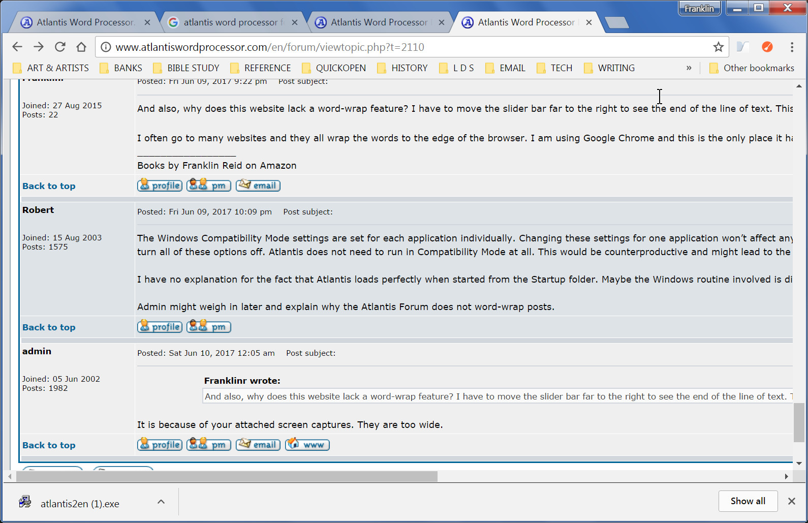

Thanks, Admin. I'm not talking about the posted screenshots, they are never too wide to post on many other websites. I am talking about the text on this forum. Here are two screenshots from this forum page. First shows the normal screen with the text running off the screen to the right.

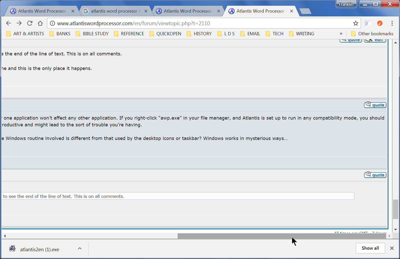

The next one is the screen scrolled to the right to see the end.

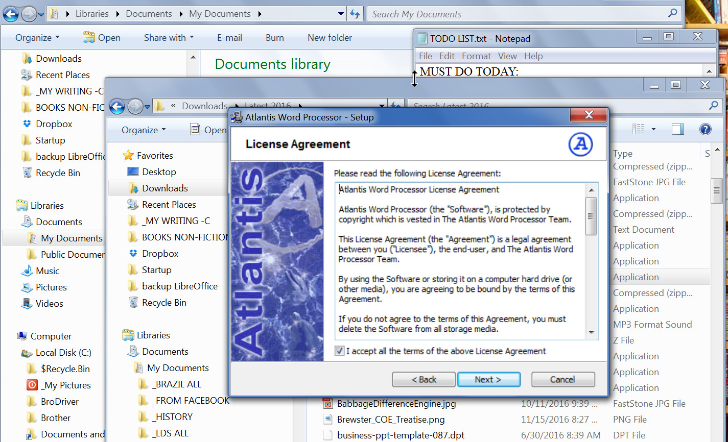

Again, this only happens in Atlantis related products. I deleted, removed, the program from the computer then downloaded the version 2.0.6 again and tried to install it. In this shot you can see all the other programs are sharp and crisp but Atlantis Setup is unsharp and fuzzy.
I hate to give up my Atlantis, it has been my mainstay word processor for several years. I used it to break away from MS Word in 2010 and have written five books with it which are now on Amazon. But if this can't be fixed for my work then I will be looking for another wp tool. Sad, because I bought this for my work.
Clearly I need some help here.
