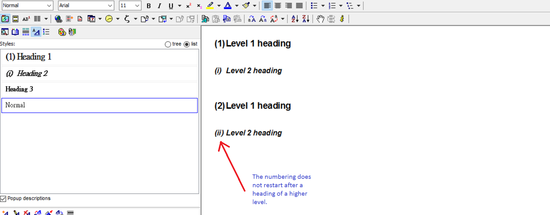

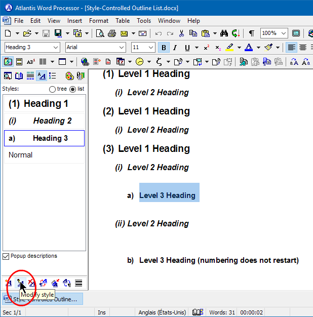

Hi all! I tried to organise a file into different headings with numbering. But the number of a lower-level heading does not restart after a higher-level heading. Please see the attached picture.
The box "Restart after higher level" has already been checked.
Any help? Many thanks.

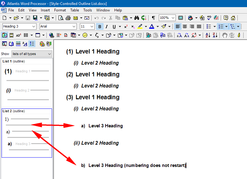

It is difficult to assess what exactly is happening without seeing the document itself. Failing that, I suggest displaying the Lists panel of the Atlantis Control Board and making sure that each of the numbered paragraphs belongs to the same outline list. The paragraph whose numbering does not restart after a higher level might very well not be included in the same outline list.
Please see attached document. Its outline list is style-controlled and the number of a lower-level heading does restart after a higher-level heading:

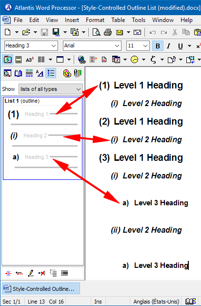

Terence,
I was going to post this answer when I saw that you had found the solution all by yourself. I am still posting my answer in case it might help others.
In my previous answer, I wrote this:
As you can see, the paragraphs associated with the Heading 3 Style actually belong to a different outline list… The paragraphs associated with the Heading 3 Style need to be included in the same outline list as the paragraphs associated with the Heading 1 and 2 Styles.
Here is how to go about this:

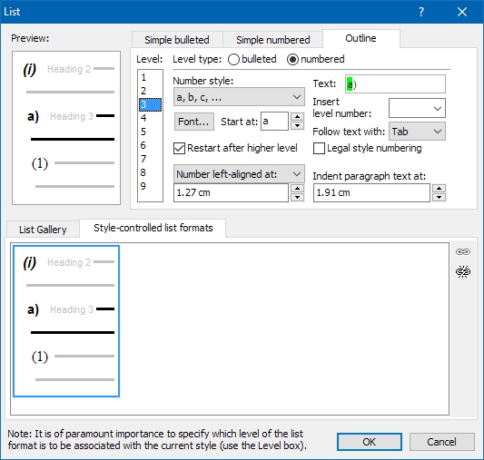

1. Place the insertion cursor within a paragraph associated with the Heading 3 Style.

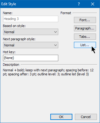

2. On the toolbar at the bottom of the Styles panel, click “Modify style”:
3. In the “Edit Style” dialog, press the “List…” button:
4. In the “List” dialog, click to display the “Style-controlled list formats”:
5. If necessary, select the appropriate Style-controlled list format.

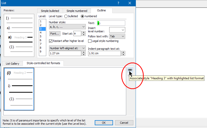

6. On the right of this same box, click “Associate style “Heading 3” with highlighted list format:

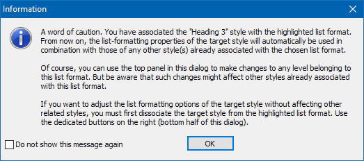

7. You’ll get a few words of caution:
8. In this (simple) case, click OK.

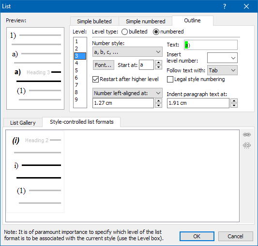

9. Back in the “List” dialog, select any appropriate settings and numbering style for the level 3 items:
10. OK out of all open dialogs. You should get something like attached “Style-Controlled Outline List (modified).docx”:
Now if I open your version of “Style-Controlled Outline List.docx” in Atlantis and display the Lists panel of the Atlantis Control Board, I get this:I suggest displaying the Lists panel of the Atlantis Control Board and making sure that each of the numbered paragraphs belongs to the same outline list. The paragraph whose numbering does not restart after a higher level might very well not be included in the same outline list.
