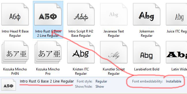

Here I have an installable licensed version of the "Intro rust G Base 2 Line" I have attached a screenshot showing that unlike the free versions on the web this i=one is installable, see screen shot. And while I was indeed able to get the League Gothic font embedded eventually this one will not embed.
I have opened the font up in font lab, to ensure that the settings are what they say, and they are, it's set to "everything is allowed." But Atlantis won't embed it.
Please note that this font will embed in a pdf from Indesign or from word. It will subset and is in our print version of the book that uses it.
But for whatever reason, it will not embed in the epub generated from Atlantis.
[/img]
- Intro rust G Base 2 Line font is installable and redistributable.
- Capture.JPG (139.67 KiB) Viewed 14994 times
As I said, Atlantis is never concerned with the “redistributable” or “installable” status of the fonts that you ask it to embed. If you ask Atlantis to embed fonts, they should normally get embedded. “Embeddability” is a licensing property. Atlantis is never concerned with this. You have to take care of the consequences of embedding protected fonts yourself.
Now I have just saved a document in both RTF and DOCX format to EPUB. Both these EPUB files included all of the font files that were saved and embedded in them, with the exception of the Intro Rust G Base 2 Line font (which I got from http://fontsup.com/font/intro-rust-g-base-2-line.html). The fonts involved were Times New Roman, Arial Black, League Gothic, Code2000, Calibri, DejaVu Sans, Intro Rust G Base 2 Line font, Symbol and Liberation Sans.
I gather that Atlantis has issues with the Intro Rust G Base 2 Line font.
I am sure that the Atlantis developers will look into this promptly.

Thanks Robert and I must have misunderstood your previous comment. I didn't think Atlantis was worried about redistribution of fonts. Etc. I don't know why this is happening on my end though because League Gothic was really giving a problem. I almost wonder if it is something wonky with the latest MS word. At any rate I need to solve this we do a lot of high dollar limited edition books. And the artists are quite adamant about the digital editions sometimes. Thanks for your efforts.
As far as the Intro Rust G Base 2 Line font is concerned, it is a rather special font with very few characters in it. This might be a factor. Let’s wait till the Atlantis developers make comments about this particular font.

The problem with this particular font ("Intro Rust G Base 2 Line") is that its "name" table includes two different names. This table contains the non-Unicode name "Intro Rust G Base" and the Unicode name "Intro Rust G Base 2 Line". Atlantis uses the first name in the font's "name" table – "Intro Rust G Base". This name does not match the font name used in the document itself – "Intro Rust G Base 2 Line". This is why Atlantis assumes that the font file for "Intro Rust G Base 2 Line" cannot be found and embedded.
The next release of Atlantis will check for such name conflicts in the font's "name" table. But I am not sure that a properly designed font should include such a font name mismatch.
