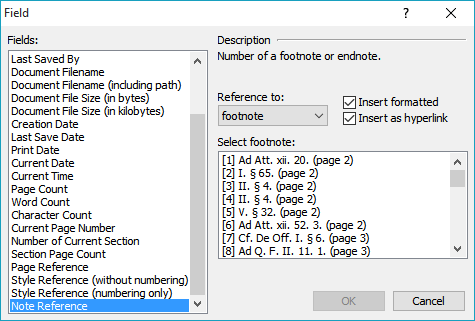

I am wondering if I can cross refer to a page and to a footnote?
As both are dynamic ...
I imagine the footnote is easier as although its number changes that is in effect a label. The footnote must have a database entry independent of the numbering it displays.
So can I link to the underlying ID of a footnote?

Hi Shan,
You can create hyperlinked field entries to any of the footnotes present in the current document. Simply click “Insert | Field…”, then select the last field type, i.e. “Note Reference”. Choose to refer to a footnote or an endnote (drop-down), then check “Insert formatted” and/or “insert as hyperlink” as desirable:

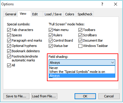

Right, there is no option to change the gray highlight color of fields. But this gray highlighting is only visible when either “Always” or “When the “Special Symbols” mode is on” is selected in the “Tools | Options… > View tab:
So if you don’t want to see this gray highlighting, simply switch the “Special Symbols” mode off ("View | Special Symbols"), or choose “Never” in the above “Field Shading” drop-down.
