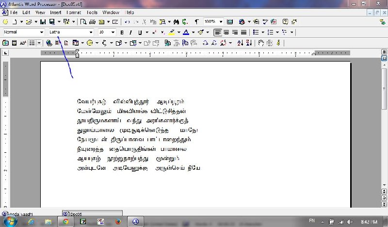

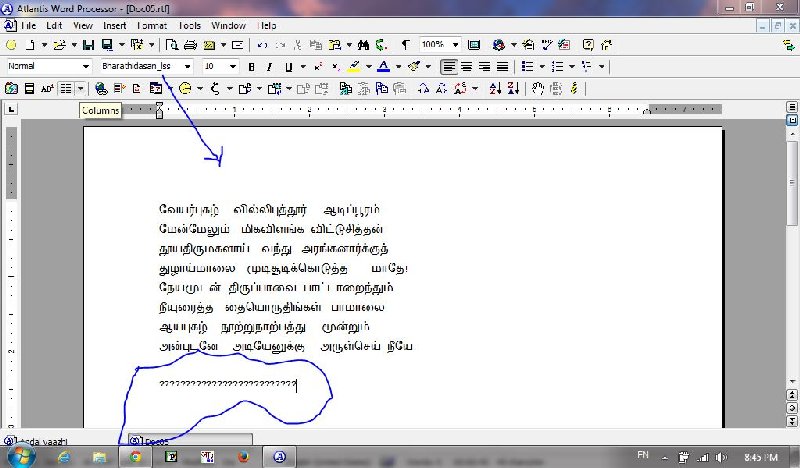

When I copy and paste unicode text from else where It is displayed properly. But when I try to type directly, I get only question marks.
And if I want to continue after pasting the unicode text again, I am getting the question marks only
Please see the attachments.
Attachment 1:( Scribus 1.jpg) A unicode text (Font Latha )-- copied and pasted displays the text correctly.
Attachment 2:(Scribus 2.jpg) I ried to type with another unicode font but gets only question marks.

Which utility (or input method) do you use to type Tamil text?
pamaran
Posts: 6
Joined: Fri Feb 07, 2014 6:48 am
Post by pamaran »
Normally I use NHM Writer(www.nhm.in/software) software to input Indic languages with English key board. I also use Azhagi (for non-Unicode fonts) and Azhagi + (for Unicode fonts).(www.azhagi.com) I occasionally use BhashaIME (sites.google.com/site/bhashaime) for Unicode input. All the three failed in Atlantis.
Pamaran,
Thiruppullani,
Tamilnadu, India
Thanks for the links. We will look into this.
