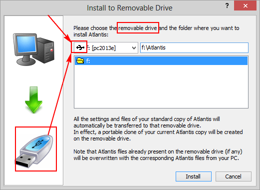

When you installed Atlantis on your USB stick did you get the graphic symbol associated with USB devices in Windows:

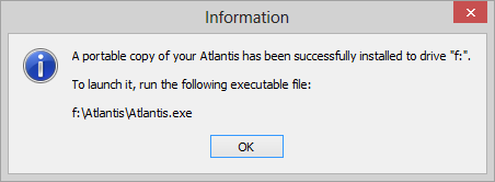

When install was finished, did you get the following message from Atlantis:
