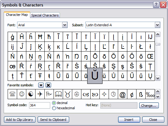

Try typing "Alt+0364" or "Alt+0365".
Or use the "Insert | Symbol..." dialog:

1) My table of symbols is different than yours. For example, „my“ Alt-code of symbol Ű is (Alt-0219), not „yours“ Alt+0369.
2) When attempt to insert this symbol in the Atlantis document, Alt-code and copy&past from the table of symbols does not work (?): the inserted symbol is displayed as some other (see).

The part of problem is cleared. There is my fault, sorry! When speaking with You, I was thinking, that I had deal with Atlantic Word Processor 1.6.5.7, bat really I had testing Atlantis Nova. :-(
And, secondly, there was some mutual misunderstanding: You was keeping in mind the Table `Symbols&Characters` from Atlantis, bat I was thinking about the similar from Windows.
Now I started the `Atlantic Word Processor`, and in the Atlantis document the symbols Ŭ ŭ are inserted by all tree ways:
  • with copy&paste from symbol table,
    with Alt-0368 and
    with Alt-x-16D.
Thank you!
