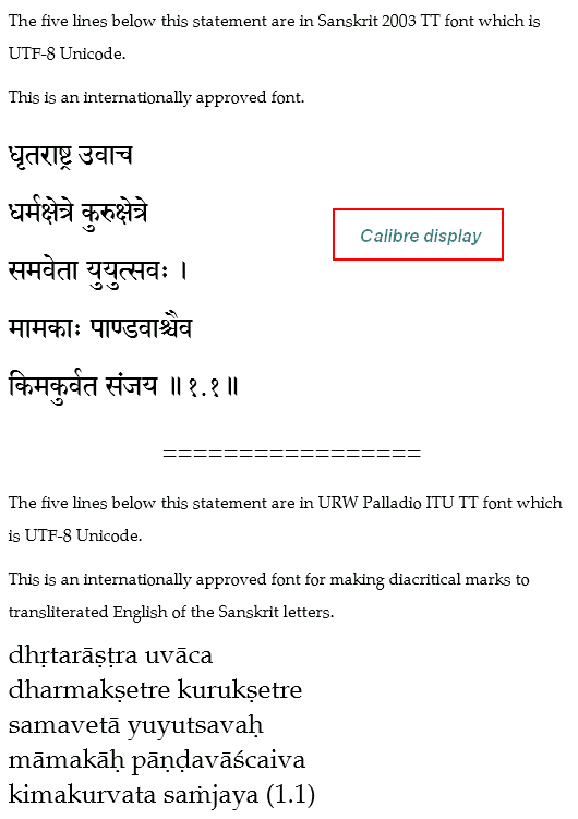

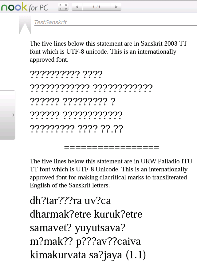

I converted your sample document to ePub from Atlantis. The ePub file displayed correctly (or so it seems to me) in the Calibre, Sigil, Stanza, Azardi, and MobiPocket viewers. It displayed incorrectly in “Nook For PC”, ADE, and the Sony eBook Library. Below are 2 screenshots illustrating the problem. So this is not a problem that Atlantis can solve. It is a problem with some of the available e-readers. Maybe you could try submitting this question to the Nook support team?

The “PubIt! Team” did write “may/might”… But the “NOOKcolor” software actually has no support for the complex algorithms required to render the intricate arrangement of characters of Sanskrit or similar languages. Support for embedded fonts is not enough.
These complex issues are addressed at http://www.nitartha.org/diacritics_how_to.html. Here are extracts from that page (bold italics are mine):
Sorry but as things stand, only a purely graphic rendering of your Sanskrit texts will do.“One important step was the adoption of the ISO/IEC:10646 standard (see [ISO10646]) as the basic document character set for HTML 4. This is the world's most inclusive standard dealing with issues of the representation of international characters, text direction, punctuation, and other world language issues. … Within a few years, these features will also allow us to use Devanagri, other Indic scripts and Tibetan in a standard way on the WWW - however the practical use of these scripts in a standard way requires that the application (i.e. browser) or rendering system handles complex context-sensitive glyph substitution and character substitution issues in a transparent manner - and such features have not yet been widely implemented across a broad range of computer operating systems and applications - let alone web-browsers. A simple one-byte-per-character encoding technique is not sufficient for text strings over a character repertoire as large as ISO10646. There are several different encodings of parts of ISO10646 (such as Unicode) in addition to encodings of the entire character set (such as UCS-4). In order to maintain backward-compatibility with older browsers and to allow the safe transmission of documents containing multibyte characters over the Internet which was designed only for 7 or 8-bit character encodings, in HTML 4 multibyte characters are either referenced by their numeric codepoint in the ISO10646 standard or encoded using the UTF-8 transformation format - a method of representing multibyte characters by encoding them as a series of single bytes.”
