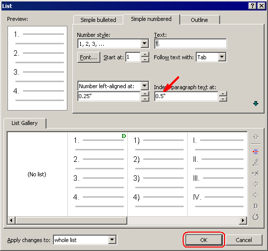

Alternatively you can do the following:
1. Click any automatic number of the list. The "Bullets & Numbers" toolbar would popup.
2. Click the "Edit list format" button Image.
3. Specify a bigger text indent, and click OK:
