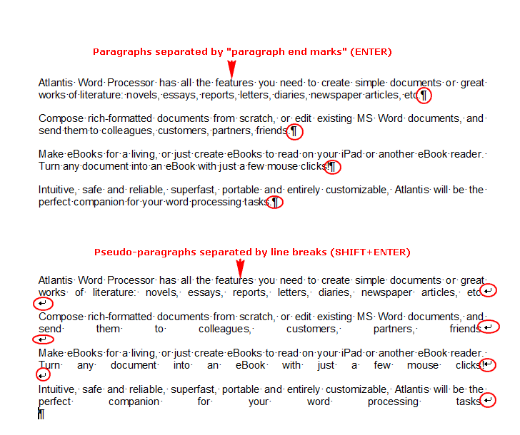

First, you must make sure that these oversized blanks are not due to the use of line breaks to create pseudo-paragraphs. Here is a picture illustrating how the space characters are treated in Justified alignment, depending on whether you create real paragraphs with the “Enter” key, or pseudo paragraphs with the “Shift+Enter” key combination:
If this is the case in your document, it would be preferable to either change the paragraph alignment to “Left align”, or to replace all line breaks with paragraph end marks:
Find:
^l
Replace With:
^p

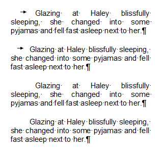

All the paragraphs on the above page start with a tab stop. This is a roundabout way to create first-line indents. But you’d be saving time and a lot of typing if you associated these paragraphs with a dedicated style, and gave a first-line indent value to the Paragraph Properties of that style. Atlantis would create the first-line indents automatically whenever you’d create any paragraph of that style. You would not have to press the tab key to introduce each new paragraph.
First, note that you’d have the same problem of big blanks with the same text in MS Word 2007, for example. But, let’s look at what’s happening in Atlantis. Below is an illustration showing the same text using different paragraph formatting values.
In the first paragraph, the first-line indent is artificially created by pressing the Tab key. The Tab Stop has its default value (3 picas on my system). As you can see, the interword spacing is big on the first 2 lines.
In the second paragraph, the first-line indent is also artificially created by pressing the Tab key. But, this time, the Tab Stop has a custom value of 2.36 picas. The interword spacing is OK.
The third paragraph has a first-line indent default value of 3 picas in its Paragraph Formatting Properties. The interword spacing is much too big here too.
The fourth paragraph has a first-line indent custom value of 2.36 picas in its Paragraph Formatting Properties. The interword spacing is OK.
So it seems you’d achieve better interword spacing if you applied a smaller (custom) value to indent your paragraphs. Here is what you could do:

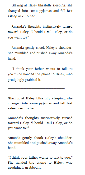

Thanks again. I applied the changes as you noted.
Applied the 2.36 picas / 0.333"
I need definite page settings as this is for a printed book 6x9, not ebook...though I suspect I'll make an ebook version shortly after.
So in the new screen capture above, the 'Gazing at Hayley' paragraph looks ok. But several others are now/still problematic.
Further down --
'Amanda's thoughts instinctively turned toward...'
'Amanda gently shook Hayley's shoulder'
Right page
'I think your father wants to talk to you'
Those are just a few examples of interword spacing that doesn't look good to my eye.
More suggestions? Would adjusting the Hyphenation help?

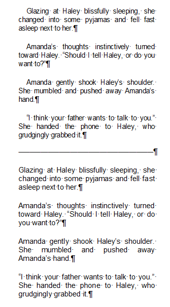

I have achieved reasonably good results with the following method:
1. Reduce the amount of first-line indenting as much as possible (desirable?)
2. Reduce the “Scale” value to “90%” in the “Format | Font” dialog (Spacing tab).
The results are illustrated in the first block of paragraphs below.
But the best results (second block of paragraphs below) were achieved by simply removing all first-line indenting and keeping the “Scale” value to 100%.
Do you really need to have first-line indents?
Note that the results also depend on which font face is used…

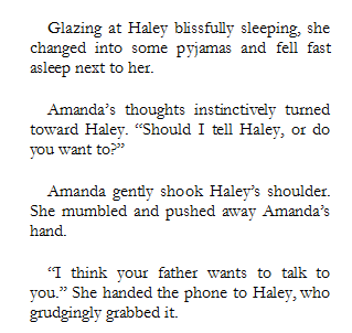

Now I have achieved best results with the “Sitka Subheading” font (11pts) which is natively available in Windows 8.1. See illustration below.Don't justify text if the lines are short or the font is large; it can create unsightly gaps and slow down reading.
- Sitka_Subheading.png (16.04 KiB) Viewed 16024 times
