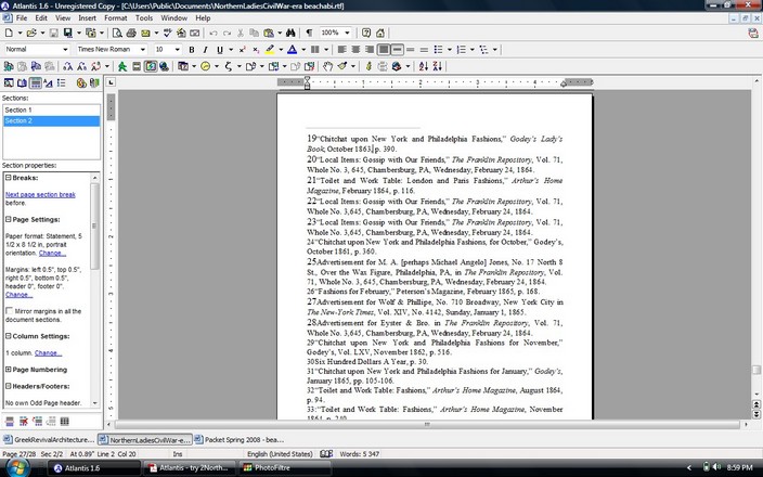

However, I've encountered three problems with the converted files that I'm not sure how to fix:
The style and font size of the endnote numbers changed. Do I have to reformat each number manually, or is there a way to change them all at once?
The page numbers were supposed to start at page 6, but never show up. In WordPerfect there is a delay code that you insert that lets you start the page numbers where you want to. If I read the online manual correctly, I'm supposed to start a new section where I want the page numbers to start, but when I tried to do so I ended up inserting a blank page in the middle of the document and never got any page numbers. What am I doing wrong?

Your suggestion for fixing the endnote numbers worked beautifully in the text! However, the numbers in the endnote section in the back still vary in style. Do I need to change them individually?
I still haven't figured out how to section properly. If I do a next page, even page, or odd page break, I end up with one or more blank pages stuck in the document. If I do a continuous break, it seems to say I can't add page numbers -- no matter what I tell it, they don't appear. What am I doing wrong?

Hi Sarah,
You could try the following regarding endnotes:
1. Display the Control Board Styles panel.
2. Click to select the “Endnote Text” style in the panel.
3. On the Styles panel bottom toolbar, press the rightmost button. This will select all endnotes (or art least all endnotes formatted with that style).
4. In the document window, right-click the selection of endnotes. Choose “Endnotes > Note Options…”
5. In the “Note Options” dialog, adjust all relevant properties, including where to “Apply changes to”.
6. Press the “Apply” button to validate your settings.
If this doesn't work, try this:
3. On the Styles panel bottom toolbar, press the second button from the left (“Modify Style”).
4. Use the “Edit Style” dialog to adjust all relevant properties to your liking.
5. OK out of the dialog.
About page numbering in sections. It is difficult to tell without seeing the actual document(s). But you could try this:
1. Insert a section break.
2. Display the Control Board “Sections” panel.
4. In the “Sections” panel, select the section where you want the numbering to start (it will be the section following the break).
5. Click the “+” sign to the left of the “Page Numbering” caption.
6. Click to follow the “Change…” link.
7. In the “Page Numbering Format” dialog, click the “Start at” radio button. Specify any appropriate number.
8. OK out of the dialog.
This should work. Note that the page numbers are normally displayed either in the headers or the footers. You might not see them simply because they are grayed out when the headers or footers are not displayed. To display headers and footers, click “View | Header And Footer”.

I have not been able to get the endnote number style to change yet in the endnote section in the back, but am changing them individually.
Is it possible to take off the line at the top of the pages in the endnote section? I cannot see where the document decides to add this, so haven't been able to figure out where it is coming from. (One thing I did like about WordPerfect was that you could turn on a window at the bottom of the document that showed what codes, etc. were inserted -- and you could delete what was fouling up the document. Of course, you could get in a lot of trouble and make a mess doing so, but sometimes it was the only way to get rid of problems!)
I am looking into your suggestions for ways to convert the old WP documents.
Could you please send a screen capture showing this unwanted line?
Please click here for information on making screen captures and attaching them to your forum posts.
Thank you so much for adding my request to the wish list!

Hi Sarah,
Endnotes are by definition endnotes. You cannot add new sections after them. This is a standard "feature".
If your address books can be converted to text files, Atlantis will be able to use them provided they have the following format:

You can start a new section after endnotes if you instruct Atlantis to display endnotes at the "end of section" not at the "end of document". Just choose the "Insert | Footnote..." menu command, and choose "Location > Endnotes > End of section". Click "Apply". Then click immediately after the last printable character of Section #1 (ie immediately before the last paragraph end mark of Section #1), and insert the desired section break through the "Insert | Break | Section Break" menu.Sarah wrote:Is it possible to start a new section AFTER the endnotes?
Putting the endnotes at the end of the section and then starting a new section worked. Now, I have three sections: the first one does not have page numbers, the second section does, and the third section I also do not want to have page numbers -- but it does have page numbers.
The third section starts at page 1 (at first it was continuing the page count from section 2, but I played with it until it starts at 1 now). If I try to delete the footer in order to take the page numbers out of the last section, it takes out the page numbers in the previous section as well. If I try to delete the number out of the footer, it also takes the page numbers out of section 2. Sigh . . . . what do I try next?
Thanks so much for all your patience!
By default, all the document sections share the same set of headers and footers. But you can create "own header" or "own footer" for any section. Just click in the header of Section #3, then uncheck the "Same as previous"
button of the "Header and footer" toolbar. In this way Section #2 and Section #3 each will have its own header.

When I try to get tabs with dot leaders, I still can't get the dot leaders to appear. I select the paragraph, go to tab set up, select option 2 (which appears to be periods), and . . . nothing. I've tried typing the periods in by hand, but since I haven't figured out how to get full justification, I end up with uneven lines.
I know I'm missing something simple here, but I have gone back and re-read the help section on tabs and still can't figure it out.
I am also still having trouble with the numbering -- if I try to alter the page numbering in the third section it takes out the second sections page numbers as well. Every time I click on "create own odd page footer for section 3" the cursor is moved back to section 2's footers and anything I do affects everything. As far as I can tell, though, I have already told it not to use the same header and footer as section 2, because when I try to tell it again not to use it, the program asks me whether I want to remove section 3's header and footer and use the previous sections instead.
Arrgh! I know I have a steep learning curve, but I'm just frustrated at this moment.
I did talk to the print shop that we use and they said that they can take out the lines on the endnote pages. Perhaps the simplest thing would be to ask them to take out the page numbers in section 3 as well?
You could not achieve the desired formatting in your document without understanding how tab characters work. If you are not familiar with tab characters of Atlantis (and MS Word too), please click the following link:
http://www.atlantiswordprocessor.com/en ... l/tabs.htm
Please click the following link to download a simple document with right-aligned tab characters with dot leader:
http://www.AtlantisWordProcessor.com/en ... leader.rtf
Atlantis could not switch to Section #2 when you create "own header or footer" for Section #3. Please double-click the footer of Section #3 in your document, then uncheck the "Same as previous"
toolbar button.
If you still cannot unlink the headers/footers of Section #3 from Section #2, please send your document to support@AtlantisWordProcessor.com. We would send you the modified version of your document.
toolbar button.If you still cannot unlink the headers/footers of Section #3 from Section #2, please send your document to support@AtlantisWordProcessor.com. We would send you the modified version of your document.
