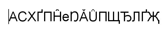

Please download and unzip the following RTF document, and open it in your Atlantis:
http://www.AtlantisWordProcessor.com/en ... acters.zip
It should display in Atlantis in the following way:
How does it display in your Atlantis? You could attach a screen capture to your forum post (click here for tips on creating screen captures and attaching them to your posts).
Windows XPadmin wrote:Which operating system do your use?
OKadmin wrote: Please download and unzip the following RTF document, and open it in your Atlantis:
- ClipBoard-1.jpg (9.27 KiB) Viewed 19049 times
