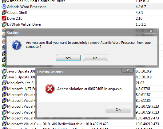

@admin:
I was able to install Atlantis on the flash drive, activate it, and import my saved Atlantis.ini and everything works well.
Of course, most of the time Atlantis does work well on my end. Until it doesn't.

Don't read into me posting one more time, it's not what you think. I was actually uninstalling Atlantis and going back to TextMaker instead because I'm done with this sideshow.
Guess what happened when I uninstalled Atlantis just now? No really. Just guess.
Just to be overly clear yet again: no, no instance of Atlantis was running. But as I just mentioned twice, awp.exe gets called when you uninstall Atlantis and then this happened. The ini file was fine, right? You guys checked it out and it wasn't throwing errors while I was using it, this time (yet). No, I'm not implying it's caused by the .ini file or anything else. One has to be this disclaiming when someone willfully misinterprets you.
My experience here has been simply like this: being met with maximum prejudice and inexcusable ill will, and minimum inquisitiveness and good will.
To then do a final uninstall and get this... the cherry alright.

- Image 1.png (38.23 KiB) Viewed 28908 times

If your copy of Atlantis always reports the same error address (0067940B), it corresponds to a basic routine used by tons of modules and features of Atlantis. So in this particular case, the error address itself is not of much help.

When compression is not included in the file properties of "awp.exe", I can uninstall Atlantis without a glitch. All this is as reproducible as possible.

TO NOTE: Robert says he can reproduce the/a access violation at will when enabling OS file compression. So in that instance it is of course not hard to reproduce and I would think you'd want to look at that first at foremost. Correct?
I did not enable “OS file compression”. I enabled file compression exclusively for “awp.exe”.
However, last night, my Windows system got automatically updated to the latest available build (19043.1237).
And uninstalling a compressed “awp.exe” executable now no longer produces access violations.
Problem solved as far as I am concerned!
