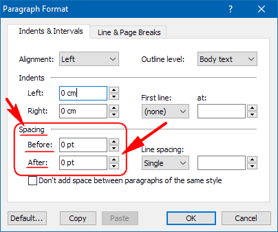

I don't know what spacing before or spacing after means. Spacing before what? After what?
But what worked is I CHECKED the box. Not unchecking.
And that solved the spacing discrepancy.
357mag wrote:I don't know what spacing before or spacing after means. Spacing before what? After what?
Spacing before and after the selected paragraph(s) in points:
