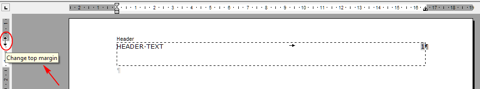

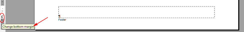

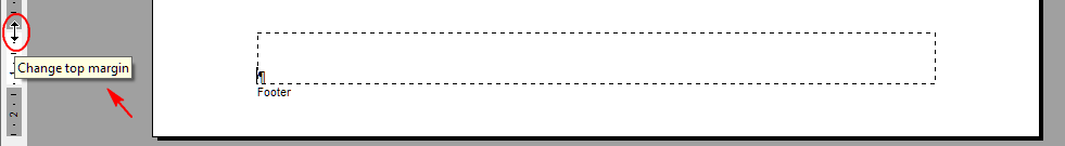

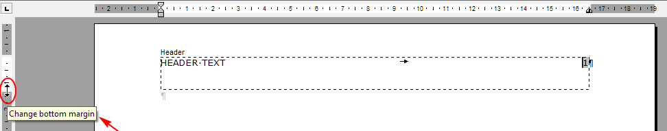

Atlantis does not support character styles, only paragraph styles. So if you want to use styles to control whatever is in the Header & Footer areas, you need to use two different paragraphs, each with its dedicated style: one for the Header text, the other for the page #. In other words, if you have the Header text and the page # within the same paragraph, and you want to have different font formatting for the page #, it cannot be done through style. You need to apply the font change manually from within the Header. This means “viewing” the Header and Footer areas.
Now if the space between the top text and the header is too big, you can reduce it. The easiest way might be to use the vertical ruler and the mouse. If you place the mouse pointer above the line materializing the Header top margin, your mouse cursor will change into a double arrow. Keep it that way and click. If you then move your mouse up or down, you will increase or decrease the Header top margin. You can proceed in the same manner for the Header bottom margin, and for the Footer own margins. Please see attached pictures.
The paragraphs within the Header and/or Footer areas have Paragraph properties (through the associated style, or through manual formatting). You can reduce the Spacing Before and After values of these paragraphs. They will take up less vertical space.

- footer_bottom_margin.png (3.46 KiB) Viewed 10989 times
- footer_top_margin.png (3.51 KiB) Viewed 10989 times
- header_bottom_margin.png (5.65 KiB) Viewed 10989 times
- header_top_margin.png (5.84 KiB) Viewed 10989 times
Never knew about that side arrow margin...handy visual feature.
