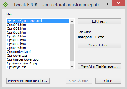

Now execute "tweak_epub.exe", direct it to “sampleforatlantisforum.epub”, and open it in “Tweak EPUB”.
You should get this:
Select “002.html” and click “Edit File…”

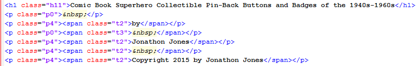

Within the code of this file, you’ll see this:
The paragraphs that you want centered onscreen are associated either with the “.h11” or with the “.p4” CSS class.

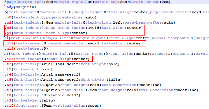

Now, go back to the Tweak EPUB main window, select “style.css”, and click “Edit File…”
In “style.css”, the code associated with “.h11” is “.h11{text-indent:0;page-break-after:avoid}”; the code associated with “.p4” is “.p4{text-indent:0}”.
Normally, and this is the case with ADE and Kindle, the “.h11” and the “.p4” default properties are inherited from their “parent” style, i.e. “h1” and “p” respectively. If you look at the “h1” and “p” lines of code, you should notice that they both include “text-align:center;” in their properties. Accordingly, the eReaders should associate their derived styles (“.h11” and “.p4”) with “text-align:center;”. But the Google Play EPUB parser simply ignores this kind of inheritance. In other words, you need to include “text-align:center;” (without the quote marks) in the properties of all the style classes that are associated with paragraphs that you want centered. This is what I did in “sampleforatlantisforum(3).epub”. If you open it in Tweak EPUB, select its “style.css” file, and click “Edit File…”, you’ll see that all the classes associated with paragraphs that you want centered include “text-align:center;” in their properties:
I have added this “text-align:center;” property myself manually with the help of Tweak EPUB and Notepad++.
