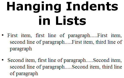

I have created demo files. Please see attached files.
“Hanging Indents in Lists (Automatic).docx” includes a basic automatic bulleted list with hanging indentation. I assumed that hanging indentation was what you wanted to achieve in your EPUB file.
“Hanging Indents in Lists (Automatic).epub” is the EPUB file that Atlantis generated from “Hanging Indents in Lists (Automatic).docx”. Among other paragraph properties, the original indentation was lost in the conversion.
I then reopened “Hanging Indents in Lists (Automatic).docx” in Atlantis, and converted the automatic list to manual. I got “Hanging Indents in Lists (Manual).docx”, which converted to “Hanging Indents in Lists (Manual).epub”. This latter file displays as intended with its hanging indentations in ADE.
Of course, you can adjust the value of the indentation to suit your own requirements.
So again, all you have to do is to create automatic lists with all the required paragraph properties. Then turn them into manual lists. And save to EPUB.

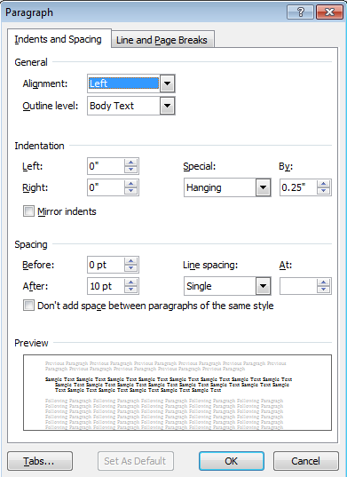

Hi Joel,
I just downloaded my own demo files.
“Hanging Indents in Lists (Manual).docx” displayed as intended and as expected in Atlantis 1.6.6.1, and “Hanging Indents in Lists (Manual).epub” displayed as intended and as expected in ADE.
First, EPUB files must be opened in appropriate eReaders like Adobe Digital Editions, Sony Reader for PC, Nook for PC, or CoolReader, to name only a few. There is no reason why the EPUB files that I posted should ever come over as ZIP files in any proper eReader.
Now from your latest post, it seems that we have been talking at cross-purposes. You say that you “have been using hanging indents all along”. But “hanging indents” are also called “negative indents” and they are traditionally designed with one main characteristic. Here are two definitions of what a hanging indent is:
Hanging indent:
Note that “JoelList_BeforeManualization.docx” uses an outline list, which is overkill for what is intrinsically a simple bulleted list. Outline lists are more complex to create and to manage. If you don’t actually need them, stay away from them.
This said, I have tried to save bulleted lists with flush-left alignment of text to EPUB. I haven’t managed this feat (yet). These things can easily be created in Atlantis, but saving such formatting to EPUB seem currently impossible. I think we would need to be able to indent/outdent the body text and the bullets independently. This is not currently available in Atlantis.
I’ll post a new message if I can come up with a solution. But I doubt it. As you know, EPUB coding uses HTML and CSS. And, as said at Align Lists Flush Left,
So I think that the Atlantis developers will have to look into the way Atlantis saves lists to EPUB, irrespective of whether they are automatic or manual lists.

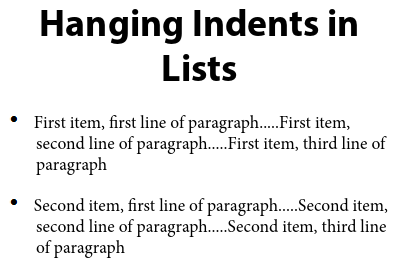

Robert, thanks for spending yet more time to write on this issue.
FYI, see attached FIGURE 1. The listed files shown are exactly as I downloaded them from the forum. (I downloaded the epubs freshly today after apparently having deleted the previously downloaded zipped versions.) The zip files correspond to your two epub files. FIGURE 2 shows the unzipped form of one of them. Did the epub files that I subsequently sent likewise arrive to you as zipped archives? If so, is something happening at the forum site to epub files? If so, perhaps Atlantis needs to check into this phenomenon. If not, maybe something at my end --- though my PC routinely stores my epubs correctly and opens them nicely in Adobe Digital Editions.
FIGURE 3 shows the result of adding my additional indent-to-spaces step to your April 29 suggested workaround. (FIGURE 5 shows the corresponding mobi file in Kindle For PC -- not as nice, but usable.) Suitable for my purposes --- so long as it works dependably. (I've not yet applied this two-step workaround to numbered lists and to lower-level lists with larger indents, but it should work for them in principle. Perhaps I'll comment again for other readers after I've tried the approach on different types of lists.) Your manualization suggestion was key to this endeavor. Thanks again for posting it.
NOTE: Before my previous post, I had briefly tried working with a manualized SIMPLE (vs. outline-style) list. Didn't seem to behave any differently.
Concerning hanging indents, I start my docs in MS Word 2010 before converting them to e-books in Atlantis; potentially minimizes the learning curve; have used Word for years. FIGURE 4 shows the paragraph settings I've used in Word for Bulleted 1, the style used to create the demo files. (See in the figure under 'Indentation'.) Perhaps the term 'hanging indent' is used in more than one way. FIGURE 4 illustrates how I'm using the term. Not obvious in FIGURE 4 is that I've ALSO applied bulleting to the style using 'Numbering' and used Word's 'Adjust List Indents' dialog to justify the bullet to the left margin. Word indents first-level bullets by default, which is undesirable for my requirements.
From what I've casually seen, Atlantis imports Word files relatively faithfully. If you've found otherwise, I'd be interested to know the areas in which importation is errant.

- FIGURE4_HowIMeanTheTermHangingIndent.png (18.21 KiB) Viewed 17678 times
- FIGURE5_MobiInKindle4PCAfterListManualization+Replacing1stLineIndentWithSpaces.png (15.39 KiB) Viewed 17678 times

You are right. It seems that the term 'hanging indent' is used in more than one way. Technically-speaking, your lists have text with flush-left alignment. So nothing is really “hanging” as far as the textual part is concerned. But the bullet itself is literally “hanging”. This is probably why some people call such paragraphs “hanging indents” too. But traditionally, “hanging indent” applies to paragraphs whose first line of text hangs over the other lines of text.
As you say, Atlantis imports Word files relatively faithfully. But Word codes files in a very complex and rather plethoric way. If you mix that with the more simple code used by Atlantis, the results might be unpredictable at times.
Now let’s go back to the subject of indentation. As can be seen in your screen capture, the text of your whole list is displaying with left alignment. But the corresponding paragraph is designed with “hanging indentation” in Word, and “first-line outdent” in Atlantis. If you look carefully at the Preview in the Word dialog, you’ll notice that the text is actually previewed as a traditional “hanging indent”, with the first line of text hanging over the rest of the lines! In spite of this, your whole text is aligned to the left. It is because the bullet itself is outdented with same value as the first line is indented. So what is actually hanging is the bullet.
When Atlantis converts such paragraphs to EPUB, it obviously keeps the “hanging indentation” set for the first line. This is why we end up with text that is displaying as a traditional “hanging indent” in the eReaders. The bullet itself is not outdented. But, as said at Align Lists Flush Left, “it’s surprisingly difficult to left align lists” in HTML. The solution found by Jeremy Church on that site involves an elaborate trick. He suggests adding “bullets and numbers in a pseudo element displayed as a table-cell”.
Let’s hope that the Atlantis developers will look into this and come up with a viable alternative for us ordinary mortals…
