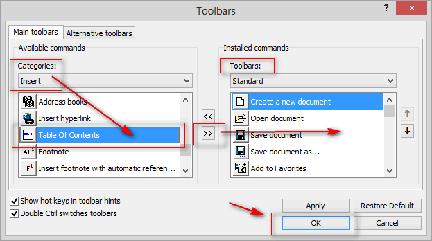

There is a dedicated toolbar button. If it isn’t already on your toolbars, you can place it this way:
1. Click “Tools | Toolbars…”
2. In the “Toolbars” dialog, choose “Insert” from the “Categories” drop-down.
3. Click within the available commands/buttons, and type “T” (without the quotes). You should get this:
4. Use the arrow buttons in the middle of the dialog to add the “Table Of Contents” button/command to your toolbars.
5. OK out of the “Toolbars” dialog.
You can now use this toolbar button to insert TOCs in your documents.

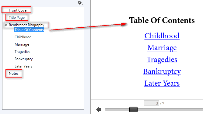

But there is an important caveat. Atlantis will use any “Heading”-type style present in your document to build the automatic TOC. In other words, you should associate each paragraph that you want Atlantis to automatically include in the document TOC with a “Heading 1”, or “Heading 2” or “Heading 3” style. All paragraphs associated with other styles will be ignored.
“REMBRANDT BIOGRAPHY.RTF” (the document attached to this message) is meant as a demo document illustrating the creation and use of a TOC in an Atlantis document. What’s more, it is a demo document illustrating the creation and use of a TOC in an Atlantis document meant for EPUB conversion. As such, it has some peculiarities:
a) As I explained above, the paragraphs that the author wanted automatically included in the TOC are associated with a “Heading 1” style.
b) The “Front Cover”, “Title Page”, “Table Of Contents” paragraphs are associated with the “Heading 1” style. They were also associated with the “Strikeout” attribute (“Format | Font…” dialog). This was done so that they would automatically be included in the navigation pane of the eReaders. What’s more, they are not included in the automatic TOC created by Atlantis in the EPUB main text because they are located before the TOC itself. Atlantis builds the document TOCs from the “Heading”-type styles it finds after the TOC insertion point. If there are “Heading”-style paragraphs placed before the automatic TOC, they won’t be included in the TOC.
c) The “Notes” heading in the source document was also associated with the “Heading 1” style and the “Strikeout” attribute. This was done so that it would be present in the navigation pane of the eReaders, but not within the text of the EPUB document itself. But this “Notes” heading has an additional characteristic. It was added to the source document only after Atlantis had build the document automatic TOC. In this way, Atlantis did not include it in the document TOC. But, being associated with a “Heading 1” style and the “Strikeout” attribute, this “Notes” heading is visible in the navigation pane of the eReaders. On the other hand, the author made sure it was visible neither in the document TOC (by adding it to the document after the automatic TOC was built), nor in the EPUB document main text itself (by associating it with the strikeout attribute):
