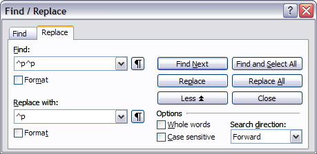

Here is how to replace manual page breaks with a paragraph end mark (removing the manual page breaks only might result in undesirable consequences):
Here is how to replace two paragraph end marks with only one:
As you noticed, a common feature of documents which result from the work of an OCR application, is that some sentences are broken over 2 lines for no apparent reason. Most of the time, the following patterns can be found:
1. pilcrow+space
In such cases, use this setup:
Find box: ^p(+space)
Replace with box: space
2. space+pilcrow+space
Use this setup:
Find box: (space)^p(space)
Replace with box: (space)
3. comma+pilcrow
Use this setup:
Find box: ,^p
Replace with box: ,(space)
4. comma+pilcrow+space
Use this setup:
Find box: ,(space)^p(space)
1. pilcrow+space
Use this setup:
3. comma+pilcrow
Use this setup:
Find box: ,^p
Use this setup:
Note that the Atlantis spellchecker (“Tools | Spellcheck…”) and the Atlantis AutoCorrect after-you-type feature (“Tools | AutoCorrect…”) will show you real misspellings or punctuation problems, but also typos created by the OCR application that you might have overlooked.
