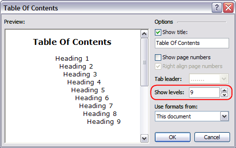

First, when you create a TOC in Atlantis, you need to specify how many Heading levels you want to include in it:
The TOC in the attached sample document was created in this way, so that it would include all 9 Heading levels. If you save this same document as EPUB in Atlantis, you get all 9 Headings in both the navigation pane and the inline TOC. Here is how this looks in the Sony Reader Library:

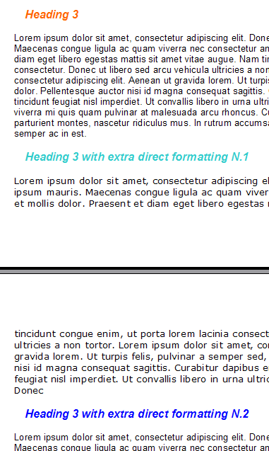

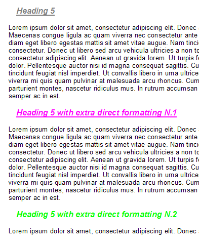

This said, you can very well have paragraphs associated with the same Heading style (level), but having different formatting. This is usually frowned upon by purists, but if you want it you can have it.
The attached sample document illustrates how paragraphs associated with the same Heading style (level) can be formatted differently. I have applied specific extra formatting to 2 Heading 3 and 2 Heading 5 paragraphs in this document (this is so-called “direct additional formatting” or “non-styled” formatting):

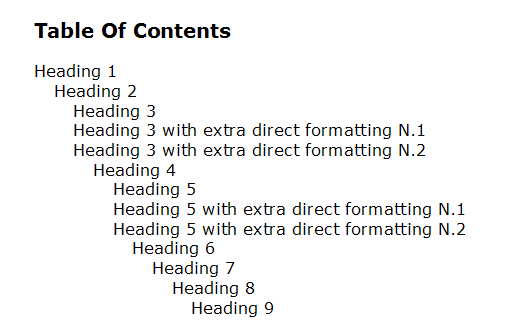

Now here is the corresponding TOC:
Note that this approach will inevitably make style changes very unpredictable, and document maintenance hell.
It runs against good document design to have Heading styles referring to the same level in the hierarchy of headings, but formatted differently. This is likely to confuse many people! The author might be the only one who really knows where each heading stands in the logical structure of the document. The specific formatting of a Heading (style) is what makes people identify its level automatically and immediately. If you use different formatting for headings of the same level, most people won’t know which level each of these paragraphs relates to.
