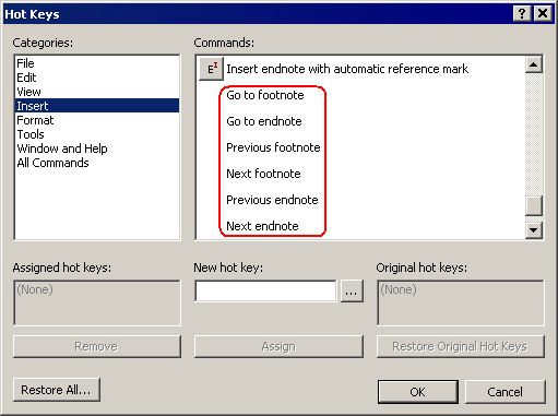

1) Move to notes if you are in document or to document if you are in notes. This is the "GoToFootnote"-command used in "PrintLayout" view in Word. Kindly test it, if you don't believe me
2) Hit Ctrl+Up/Down to move through the notes - it doesn't matter whether you are in the notes or in the documents!
Jannik
MS Word has those extra "GoTo...note" commands indeed. But they are rarely used commands, if not say more. But having them in Atlantis would not harm. They will be included in the next maintenance release of Atlantis 1.6.1.4. You could assign hot keys to these commands in Atlantis through the "Tools | Hot Keys..." dialog:
The “Go to footnote” command switches to the footnote associated with the “nearest footnote reference mark” in the document main text (when the caret is within the document main text), or switches to the reference mark of the current footnote (when the caret is within a footnote).
The “Go to endnote” command switches to the endnote associated with the “nearest endnote reference mark” in the document main text (when the caret is within the document main text), or switches to the reference mark of the current endnote (when the caret is within an endnote).
The “Previous footnote” command places the caret before the previous footnote reference mark (when the caret is within the document main text), or at the beginning of the previous footnote (when the caret is within a footnote).
The “Next footnote” command places the caret before the next footnote reference mark (when the caret is within the document main text), or at the beginning of the next footnote (when the caret is within a footnote).
The “Previous endnote” command places the caret before the previous endnote reference mark (when the caret is within the document main text), or at the beginning of the previous endnote (when the caret is within an endnote).
The “Next endnote” command places the caret before the next endnote reference mark (when the caret is within the document main text), or at the beginning of the next endnote (when the caret is within an endnote).

LOL! This is superb! Exactly what I was looking for - I can't thank you enough for being so responsiveadmin wrote:MS Word has those extra "GoTo...note" commands indeed. But they are rarely used commands, if not say more. But having them in Atlantis would not harm. They will be included in the next maintenance release of Atlantis 1.6.1.4. You could assign hot keys to these commands in Atlantis through the "Tools | Hot Keys..." dialog:
If you are interested in these new commands, you could download the following ZIP file, and unpack its contents to the home folder of Atlantis (by default, "C:\Program Files\Atlantis"):
http://www.atlantiswordprocessor.com/en ... _1_4a1.zip
