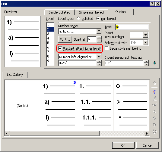

Hi, I WOULD like my second level list to go on, but it starts again from the beginning every time after a first level line is interupting the second level list. The option for Presume previous list is greyed out, so not available.
How do I do this?

What you call "second level list" is an integral part of your outline list. The right-click "Resume previous list" command can be used to join two separate lists. It has nothing to do with the levels of the same list.
Please click any level-2 item of your list, choose the "Format | List..." menu command, then uncheck the "Restart after higher level" box for the second level:
