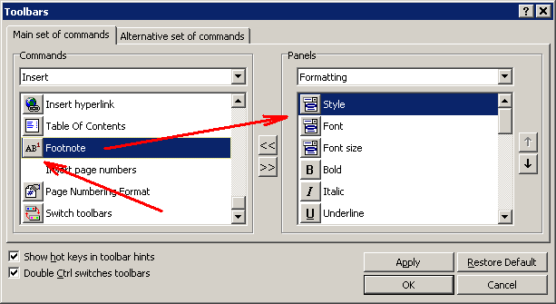

Anyway if you simply want to insert a new footnote with the automatic reference mark that has the same format as other automatic reference marks in this document section, you could place the “Footnote” toolbar button onto your toolbars. It would still display the “Footnote & Endnote” dialog, but you would only need to press the Enter key to insert a new note:

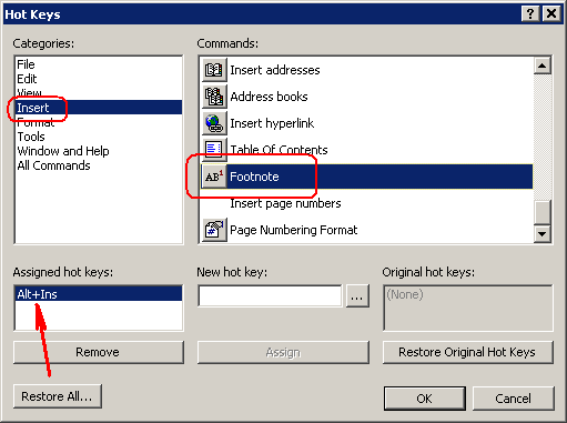

Are you sure that you assigned the Alt+Ins combination to the “Footnote” command from the “Insert” category? The “Tools | Hot Keys…” dialog should display the Alt+Ins hot key among the assigned hot keys when you select the corresponding command, and this hot key should work properly (ie display the corresponding dialog):
- Alt-Ins.gif (7.98 KiB) Viewed 11043 times

It works from time to time.
I've checked it out when you've said it should work... it worked, I've got a footnote window. But a few seconds after -- it does not work. I press shortcut, and any next key pressed gives me no reaction. Press one more key and you will get it (get the key - a letter, a space.. not a footnote). After shortcut every other key is "eaten".
I've remapped it to CTRL-SHIFT-INS and it works ok. Let it stay so.
