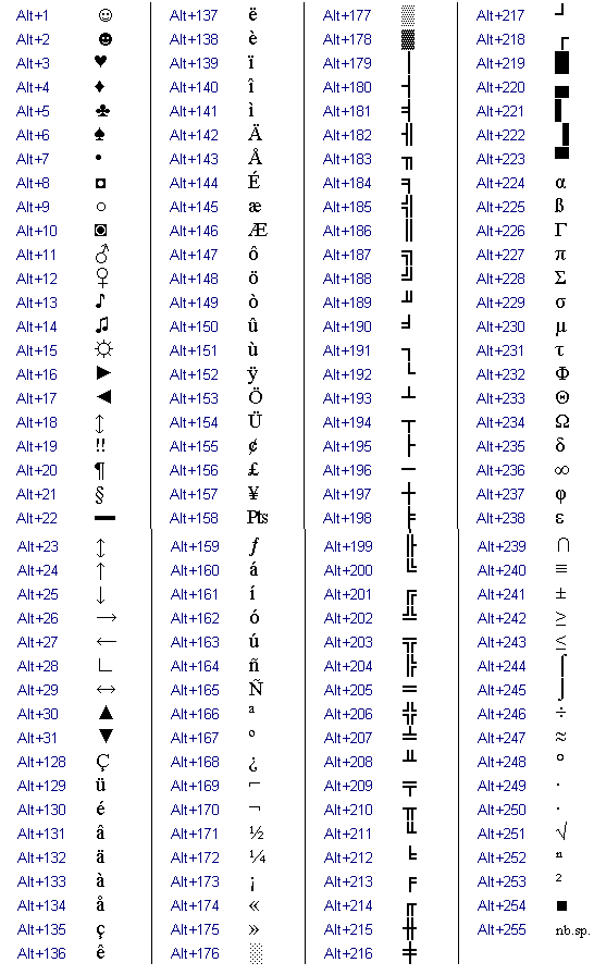

In order to be compatible with other text processing applications and national versions of Windows, the Alt+NNN mode of the next build of Atlantis will work differently than in Atlantis 1.6.1.0.
So pressing the Alt+NNN combinations without leading zero (for example, Alt+20, Alt+130, Alt+221) will insert characters from the Extended ASCII (or MS DOS ASCII, or OEM) table. The character glyphs contained by this table depend on the language of Windows. See the table below for the list of characters that can be inserted through the Alt+NNN combinations (without leading zero) in English Windows.
Pressing the Alt+0NNN combinations will insert the ANSI characters corresponding to the activate keyboard layout. Please see Windows Character Map utility (charmap.exe) for the possible Alt+0NNN combinations.
Finally, the Alt+00NNN combinations (two leading zeros) will insert Unicode characters. The Unicode codes of characters are displayed in the “Insert | Symbol…” dialog of Atlantis.
“NNN” above is a decimal code of a character. If you want to type a hexadecimal code of a character, you need to press the “X” key after pressing the Alt key. For example, to insert a Unicode character whose hexadecimal code is “221A”, you should press and hold the Alt key, type “X00221A”, then release the Alt key. ASCII and ANSI characters can be inserted in the same way – just press X before typing the leading zero (if any) and the hexadecimal code of a character.

- ASCII_OEM.gif (19.46 KiB) Viewed 53524 times
