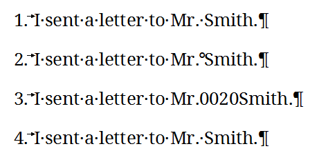

More on 'Reveal Unicode'
Oops! I discovered a problem with the "Reveal Unicode Number" feature.
The problem involves the "no-break space" (hex 00A0; dec 160).
Let's suppose that I have this text somewhere in a document:
'I sent a letter to Mr. Smith' (#1 in graphic below).
I want to put a no-break space between 'Mr.' and 'Smith' so that I can prevent a possible line-wrap after 'Mr.', because it looks dumb to have 'Mr.' at the end of a line. See #1 in the graphic below.
So I use Ctrl+Shift+Spacebar to insert a no-break space at the appropriate place. The sentence has the degree symbol to show that this is a no-break space. See #2 in the graphic below.
If I use Alt+X, after the no-break space, to check the code, I should see the code 00A0, but instead I see the code for a regular space (hex 0020; dec 32). See #3 in the graphic.
And when I use Alt+X again, to revert to the glyph, I now have a regular space (no degree symbol).
Thanks for any help that you can provide with this.

The nonbreaking space is a special character in Atlantis Word Processor. You do not need to know its code to insert it to your document. Just press Ctrl+Shift+Space. You also do not need to reveal its code in the document. Just press Ctrl+Shift+8 to enable the "Special symbols" mode, and the nonbreaking spaces in your document would display as small circles.

I know how to insert an nonbreaking space with keystrokes and that I do not need to know a code for it. I also know that a user can display the special symbols with Ctrl+Shift+8.
The reason for my original post was that I wanted to point out to you that using Alt+X after a nonbreaking space destroys the nonbreaking space (hex 00A0) and replaces it with an ordinary space (hex 0020).
In the tests that I have conducted, the use of Alt+X after other characters does not result in the destruction of that character. I have only seen this happen with the nonbreaking space.
I assume that using Ctrl+Shift+Space in Atlantis must insert the 00A0 character. I say this because if I perform a copy-and-paste from Atlantis to LibreOffice, the LibreOffice text then displays 00A0 wherever I had a nonbreaking space in Atlantis.
If this is a big issue for you to fix, then I will not worry about it. My only aim was to bring it to your attention.
