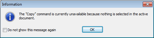

Of late (maybe since the very latest update, but I can't be sure) the following error message pops up very often:
The "copy" command is unavailable because nothing is selected in the active document.
However, whenever it pops up, I have most definitely NOT given the copy command, either by pressing CTRL+C or by clicking the icon in the toolbar.
It seems to happen most often when I'm clicking a button in the toolbar -- but never one that's remotely near the "copy" button. I'm sure of that.
Anybody know what could be happening here? Or is it a known (new) bug?

Clicking a disabled button never displays message boxes in Atlantis. The attached message box is displayed when you press a hot key associated with a command that is currently unavailable. So I do not think that all this can have anything to do with mouse clicks. But I cannot suggest an explanation either. Maybe this is somehow linked to your second keyboard or the utilities running in the background. There must be something in your system that sends a "copy" hot key to the Atlantis window.

I've just disengaged both keyboards and was still able to reproduce the faulty error report.
I notice that it happens if I *double click* in any area of the toolbar.
The reason it sometimes happens when I'm not concsiously doing that is, presumably, it interprets two separate clicks as a double click (e.g. when I'm using the zoom in or out or delete buttons and click those once or twice in quick succession).
I really cannot explain this. Something in your system must be generating the Ctrl+C(?) key combination, and sending it to the Atlantis window.

I tried factory settings just now. Had no effect, it occurred there as well.
But I think I've found the cause! You're totally right, it's nothing to do with Atlantis. It's the standalone version of the Oxford English Dictionary that's installed on my computer.
I don't use this a lot, but have been using it occasionally over the past months. And when that application is open, it hijacks Windows to such an extent that whenever you select a word by double clicking somewhere in a word processor like Word or OpenOffice, or Atlantis apparently (but not in a browser, for instance), the text is not only selected but copied to the search box of the dictionary application.
Apparently the programmers once (it's a fairly old application) thought this would be useful. I've looked in the options and there's no way to disable this
other than by closing down the OED application.
I hate that function anyway. Plus it's a little mysterious how it works: in Word or Atlantis it suffices to double click a word to send it to OED; in other applications like notepad or this browser window I would have to manually give the copy command to send it to OED (which I don't want it to do anyway!).
Well, sorry for your troubles & thanks for bearing with me.
